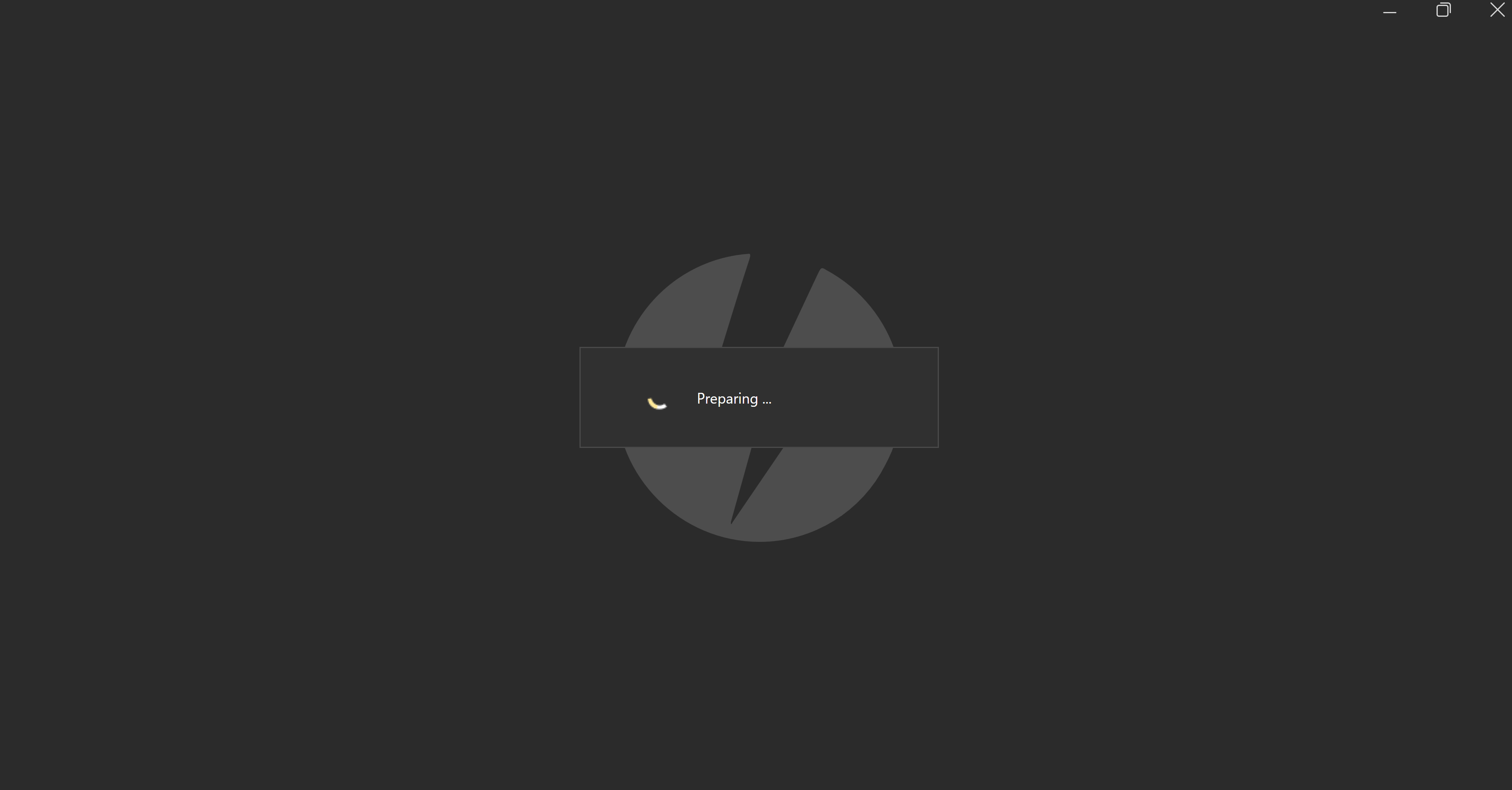

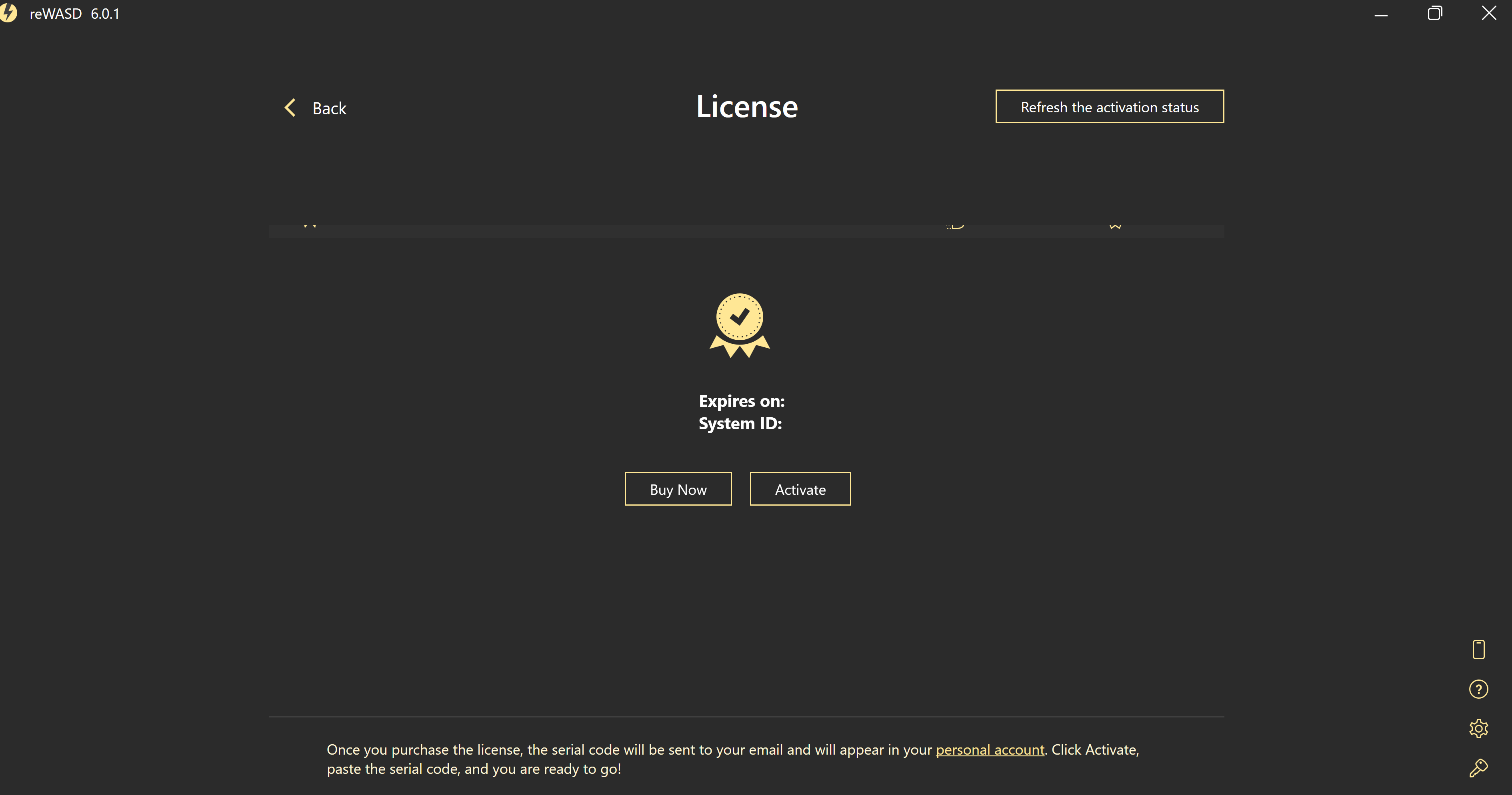

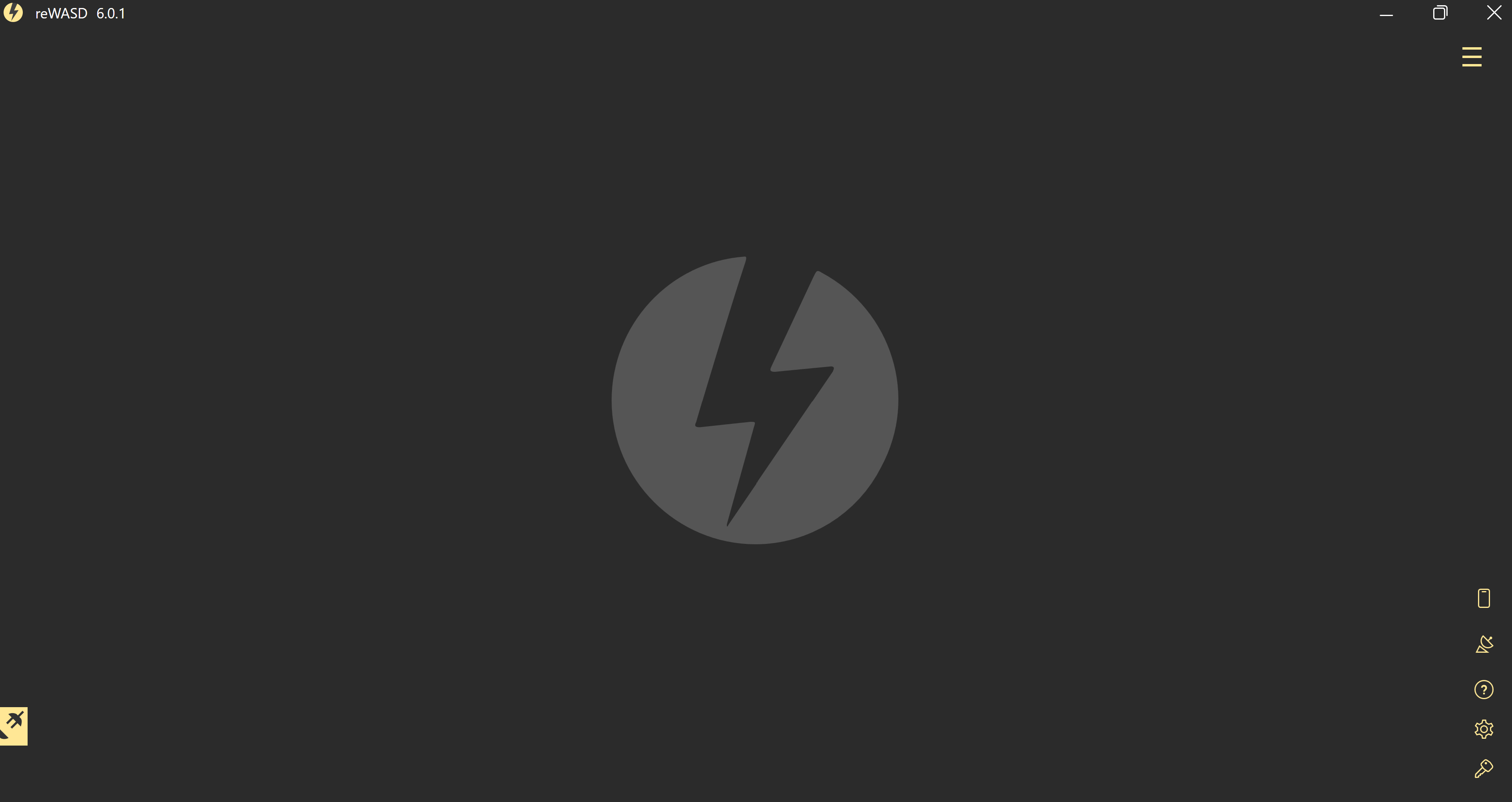

    I recently built a new PC, but ported my Windows 10 OS drive directly over. I noticed that when I go to open reWASD now it opens very sluggishly, starting by displaying "Preparing..." for 1 minute, then "Checking the license..." for another minute, then opens to the main screen but does not detect any devices (kb, mouse, controllers). When I check the license it does not seem to be active, when I paste in my serial number and press activate, the activate button goes grey and the program thinks for a minute and then says (unverified License) at the top corner of the screen and still not detecting any devices.

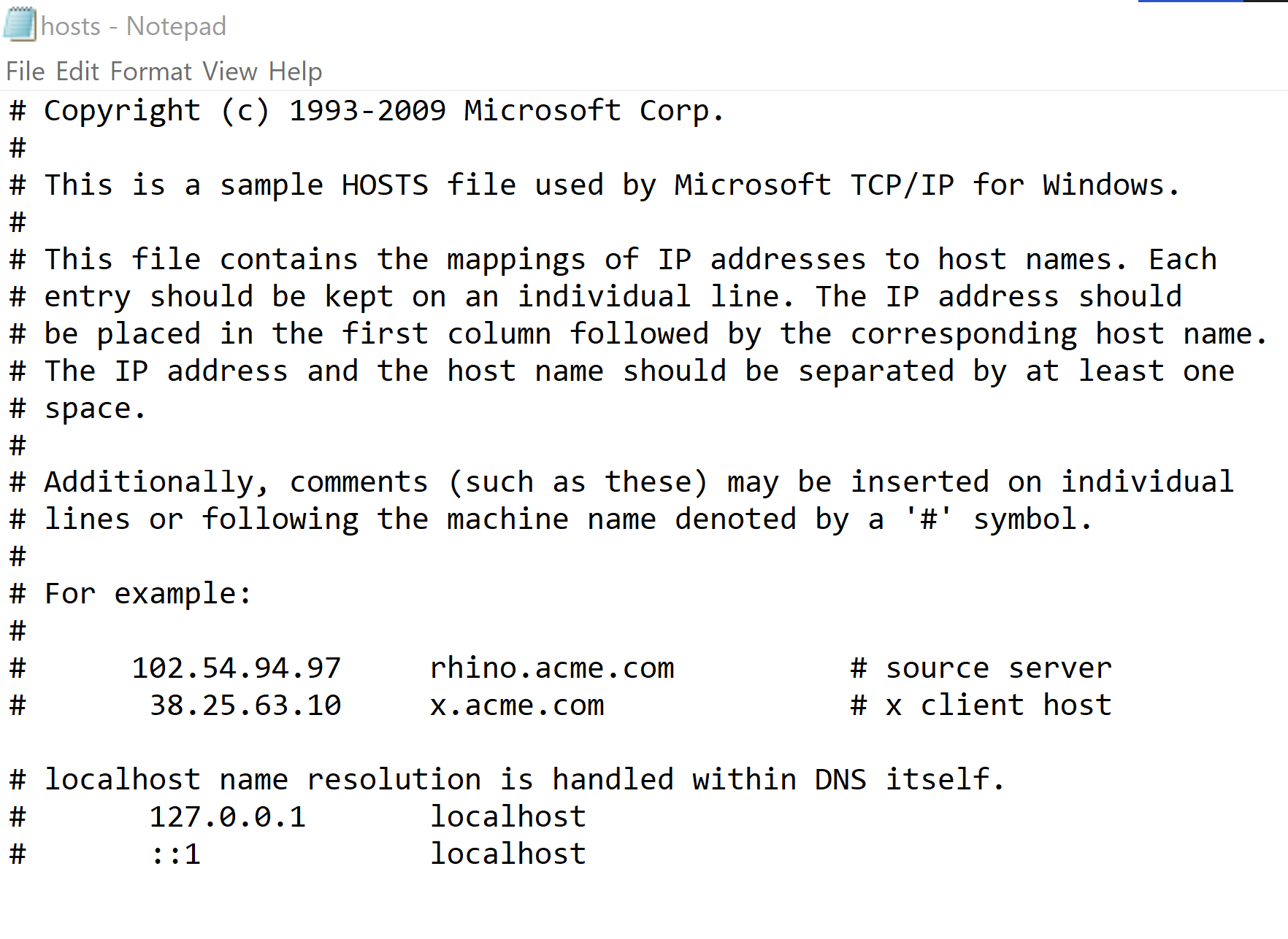

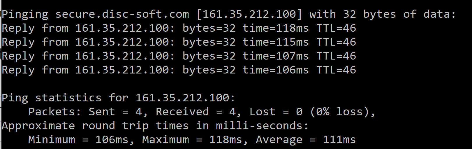

    I have checked that I can ping secure.disc-soft.com (seems to work fine), and I have checked my hosts file, but do not see anything related to disc-soft.com. I have also uninstalled MSI Afterburner (didn't see a blacklist option as described in the reWASD troubleshooting guide).
