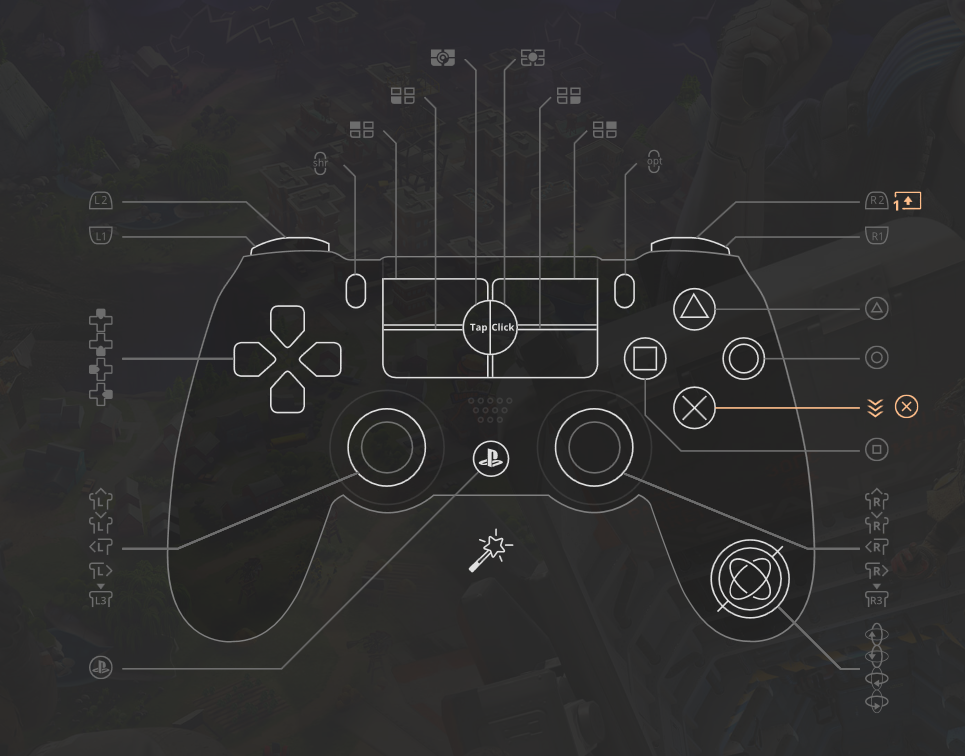

    I'm trying to create a Turbo mode for X button on R2 hold, i.e. holding down R2 and holding X will repeatedly fire X button. But when I try turning on Turbo mode under a second layer, the following diagram appears, and in game, all controller input no longer register.

    Am I doing something wrong, how should I go about configuring what I intended to do?
    Hello! On the screenshot, everything seems to be in order. Specify in more detail which diagram appears?
      By diagram, I meant the screenshot attached. After I set X to turbo mode, the controller input doesn't seem to work anymore.

            Please clarify, when you activate the turbo, does it not work or does the controller completely stop working in the game?
            I don't see anything unusual in the config. You can try changing the frequency from 20ms to 150-200ms.
              I can't use the controller at all - none of the keys (not just the turbo one) I press are being registered.
              If I remove the turbo button, the controller works as normal.

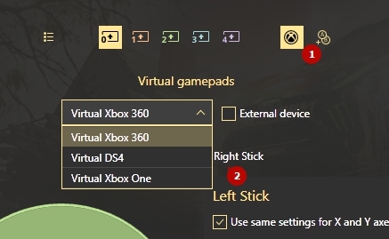

                Please check in the game which controller you have selected as active. Choose the one created by reWASD.
                If the problem still persists, then check other virtual controller types here:
                Change the type, apply a config, restart the game and check.
                  Changing to Virtual Xbox 360 seems to have fixed it. Thanks!

                        Make sure you are applying the reWASD config with the Xbox 360 or Xbox One virtual controller type selected.
                        In this case, the system, as well as the game, should recognize your controller as an Xbox controller.
