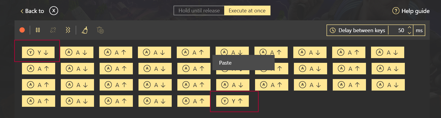

    It is possible, but you may need to perform a few tricky steps:
    1. Choose X button and go to Combo Editor
    2. Here, you need to set a long manual combo that starts from Y (press) and ends with Y (release) with many Z-buttons inside, Execute at once combo mode. Please use copy-paste function to make it easier:

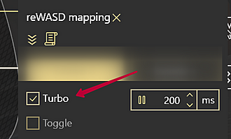

    3. Then, go Back and check Turbo option for X button — this way your combo will be working when you press and hold X button and will be stopped once you release it:
    Please note that you need a lot of Z-buttons inside, because if you create a short combo, then it will be restarted each time it runs to the end.
