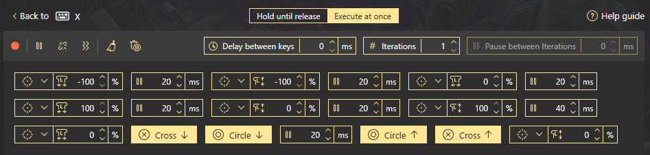

    Assuming your game works at stable 60 FPS, the combo for "quarter circle back half circle forward and 2 buttons" done with a stick with "forward" being "right" should look like this, if I understand it correctly:

    You can map this combo to any single button or a [Shortcut] of 2-4 buttons pressed at the same time. Though you might need another 20ms pause before the two buttons are pressed.

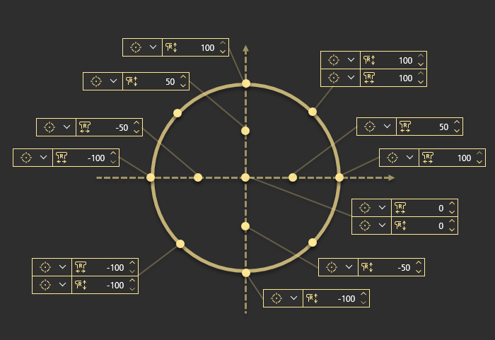

    This image might be of help when making combos with sticks in the future:

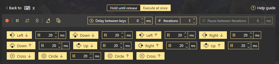

      Hi and thank you for your quick reply. I am using a dpad on my hori fighting commander octa not a stick, and can record the input in game successfully but it comes out too slow regardless of Ms (timing of the button) in between presses.
      Plus that doesn't help with the lack of left motion and right motion not being registered as it is registered as a diagonal instead of a straight left. This program has a pretty big learning curve for me it seems

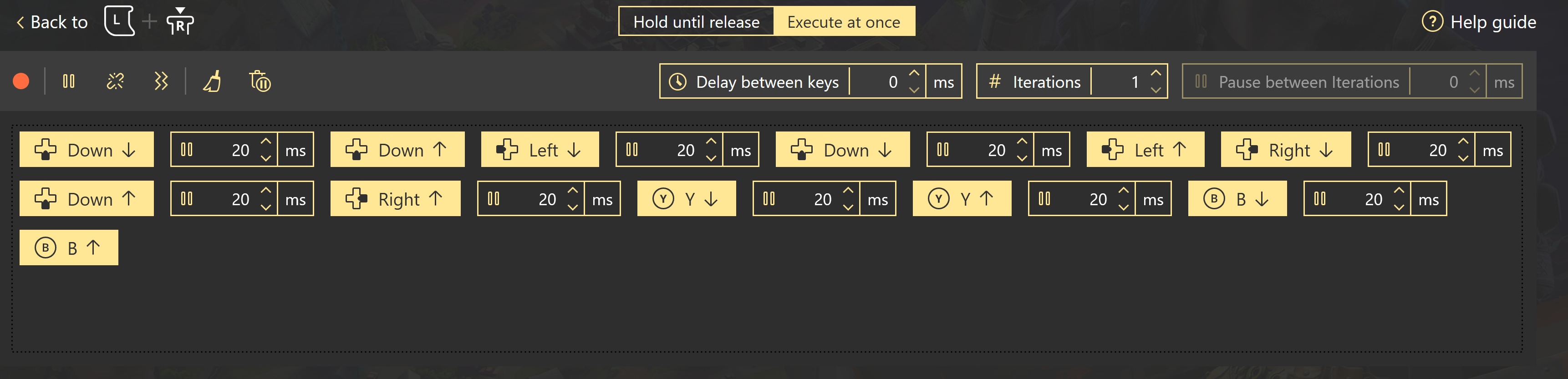

        Hmm, D-Pad then. Should be a tiny bit easier:

        If combo goes too slow or too fast - adjust the pauses. For stable 60 FPS those pauses should be at least 17ms for whatever is pressed at the moment to be detected by the game (one such pause should count as a "frame").

          okay cool. Now I have one last question. My combo list has release motions instead of just one button press like yours seems to have. How did you get it to be that way?

            I don't understand what you mean by "release motions".
            Every button has a [Press] and [Release] node. These nodes can be moved around in the combo as long as [Press] stands before [Release]. Pause nodes act as "send" command of sorts, as the pause itself gives the game enough time to check what buttons are pressed at the moment. So your task is getting all required buttons pressed before a pause node, and release the unneeded ones afterwards.
