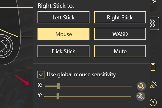

              Regarding the stick's sensitivity, I would recommend that you check three things:
              • Sensitivity under the Mouse settings of the Right Stick (increase or decrease it):

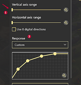

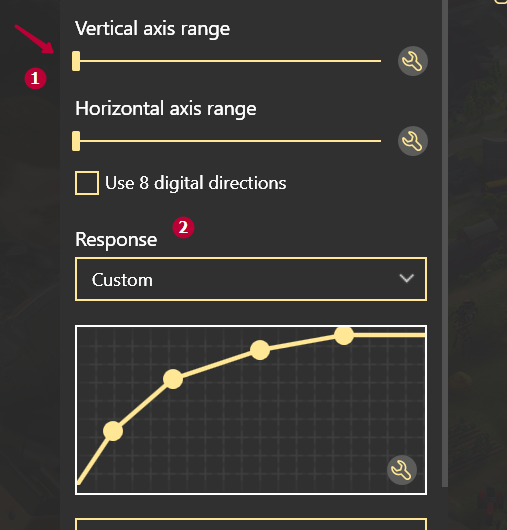

              • Minimize the Vertical and Horizontal axes range (1)
              • Try different curves for the Response (2)
