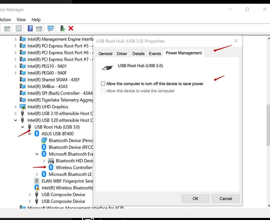

      Hey! Try disabling the following option in the system. It seems that the controller may just disconnect randomly.
      1. In Device Manager, choose View by connection view
      2. Find your controller and navigate to the Bluetooth dongle
      3. Check if it has Power Management tab in Properties
      4. Uncheck Allow the computer to turn off this device to save power
      The example below shows DS4, just to describe the idea.
      Click image for larger version  Name:	fetch?id=227560&d=1631182060.png Views:	0 Size:	247.2 KB ID:	230396

          We are working with Steam controller differently. reWASD has exclusive mode that allows us to get access to all the controls and it hides the device from the system completely. Even Steam can't access it when remap is on. So basically, Windows may decide that the controller is not active — and so it may switch it off.

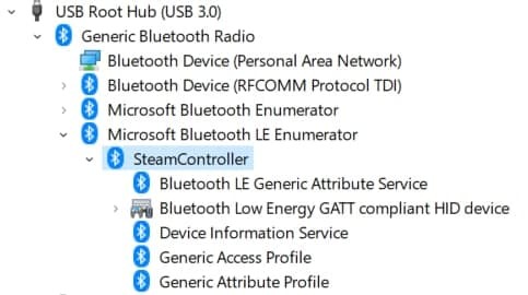

            Thanks for the clarification, I'm seeing a lot of devices, some for xbox controllers and one for steam (only steam controller is connected), so not sure which one is which. Any idea on how it shows in device manager. I've changed the power mode in most of them but not sure I picked the right one, and at least with the ones I've changed I'm still seeing the disconnects of mouse input.
            • #21
              It should be shown like this:
              • #22
                Yep, I did disable power management like that, but unfortunately it doesn't fix it. It seems like can I just use SteamInput for this game so I will probably go that route, but it would be great to try to find a solution to this issue to be able to use the steam controller in other non steam games. Thanks.
