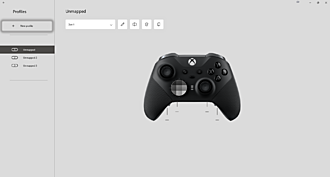

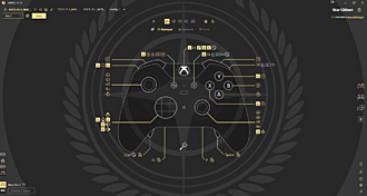

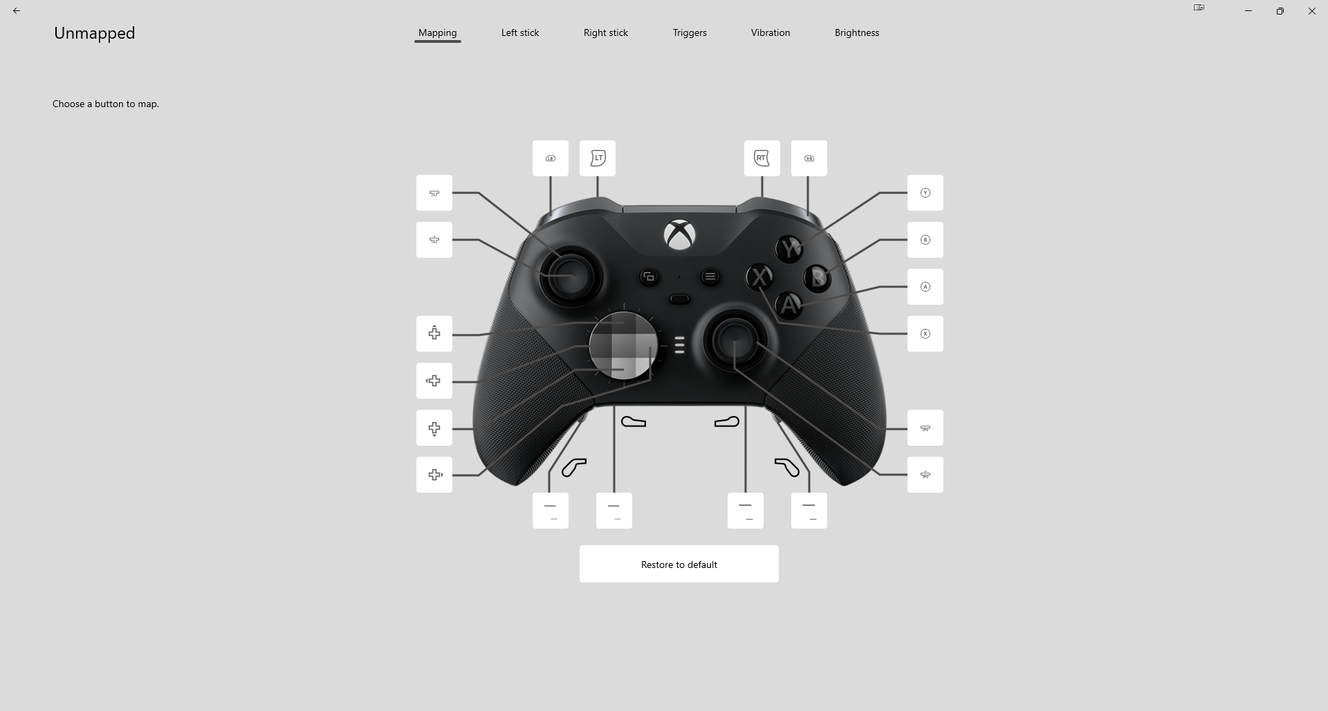

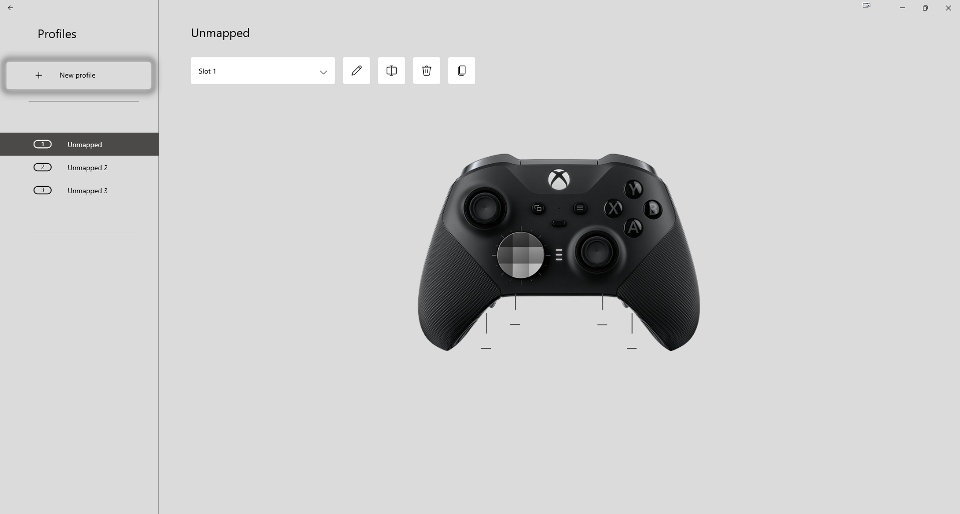

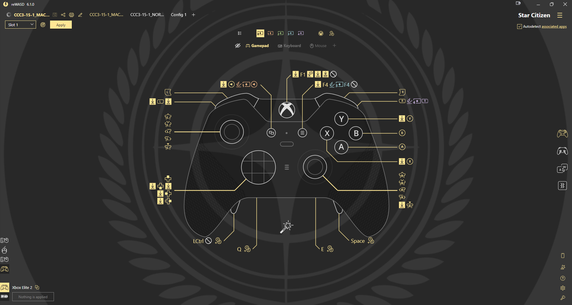

    1. Please send a screenshot of the full reWASD window with mappings on your paddles.

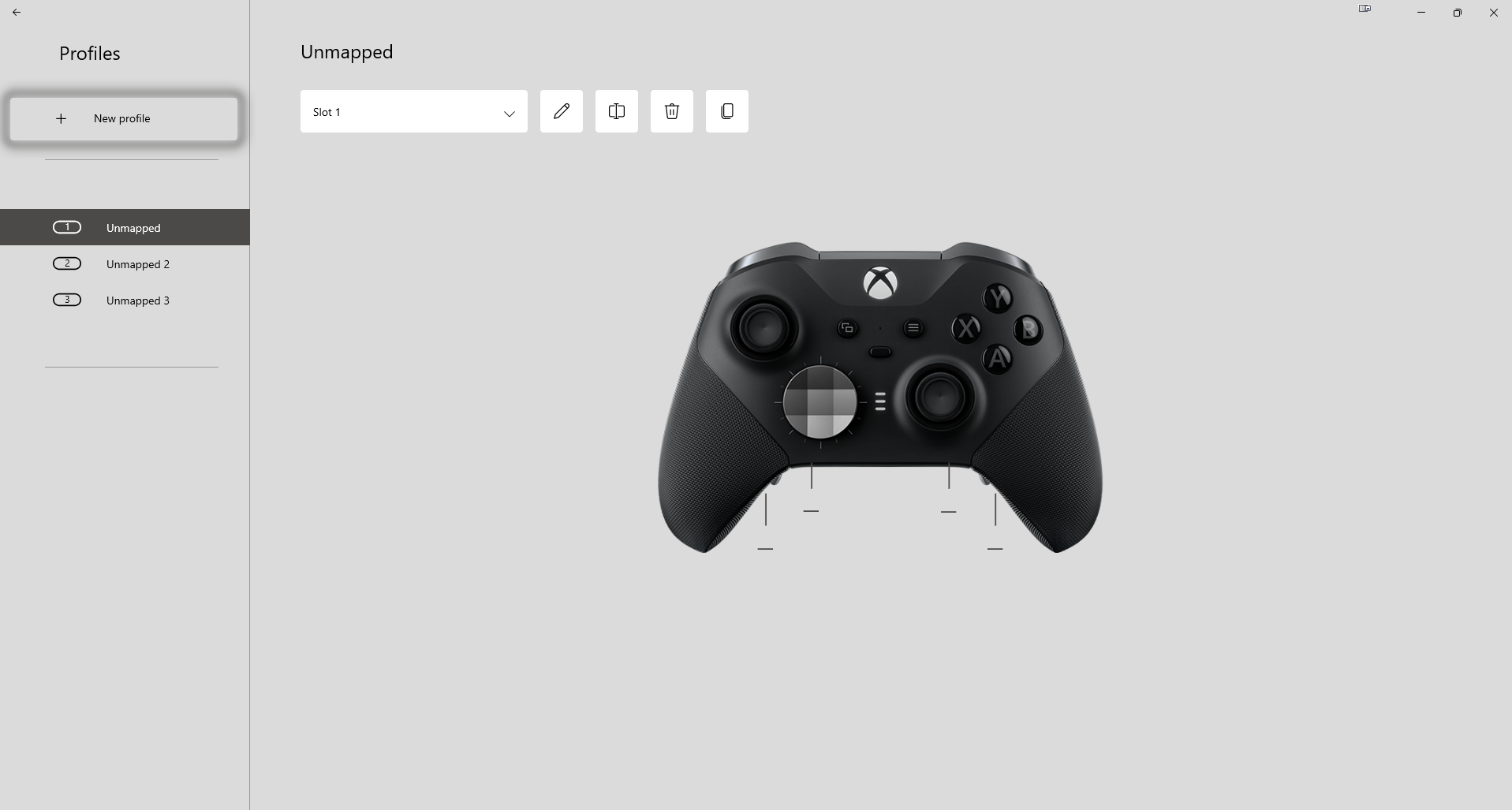

    2. Send a screenshot of the profiles from the Xbox Accessories app.
      Thanks for the response, I've attached the screenshots you asked for.
Name:	Screenshot 2022-03-11 222134.png
ID:	230845Click image for larger version
Name:	Screenshot 2022-03-11 222307.png
ID:	230846Click image for larger version
Name:	Screenshot 2022-03-11 222341.png

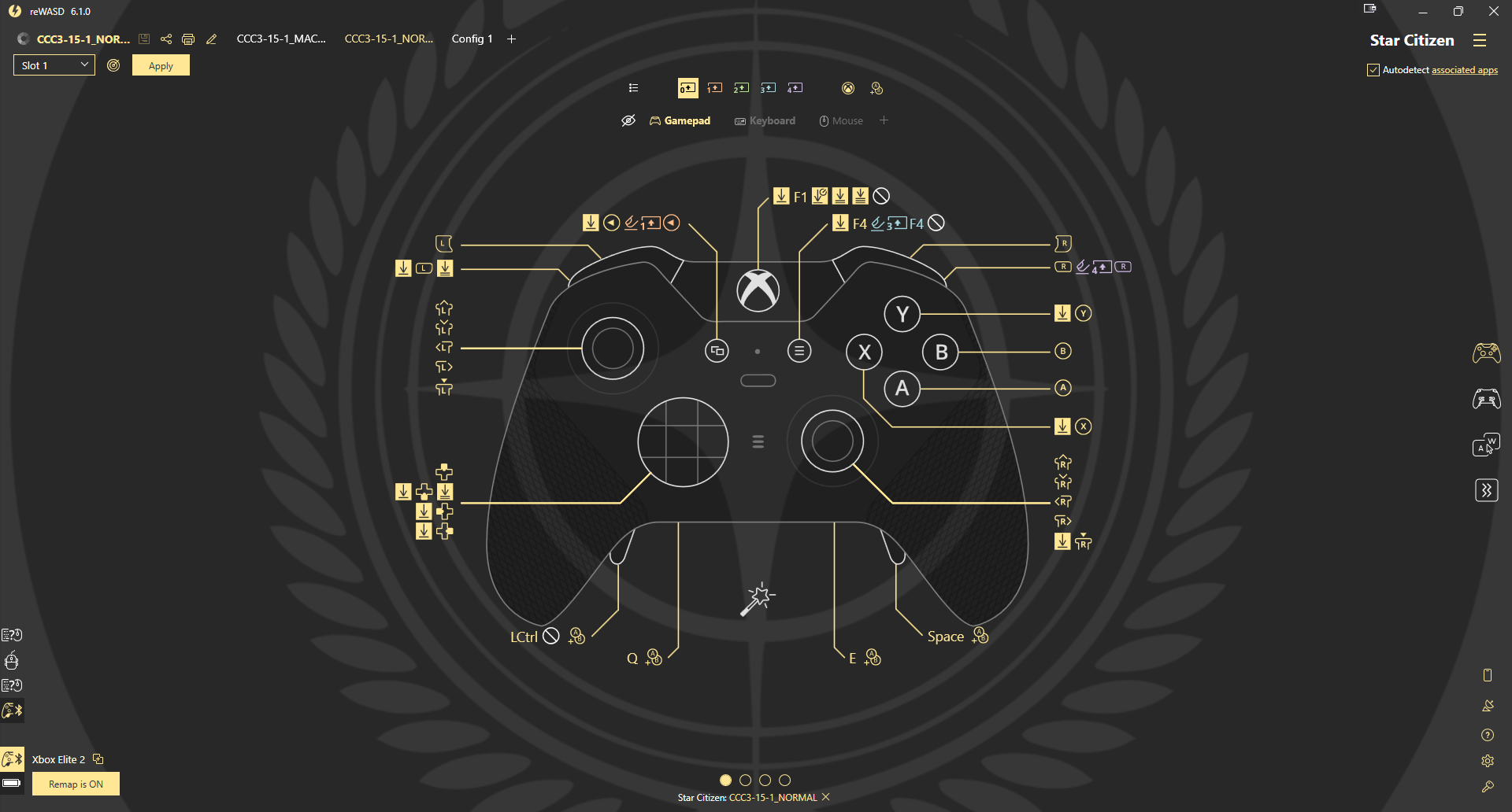

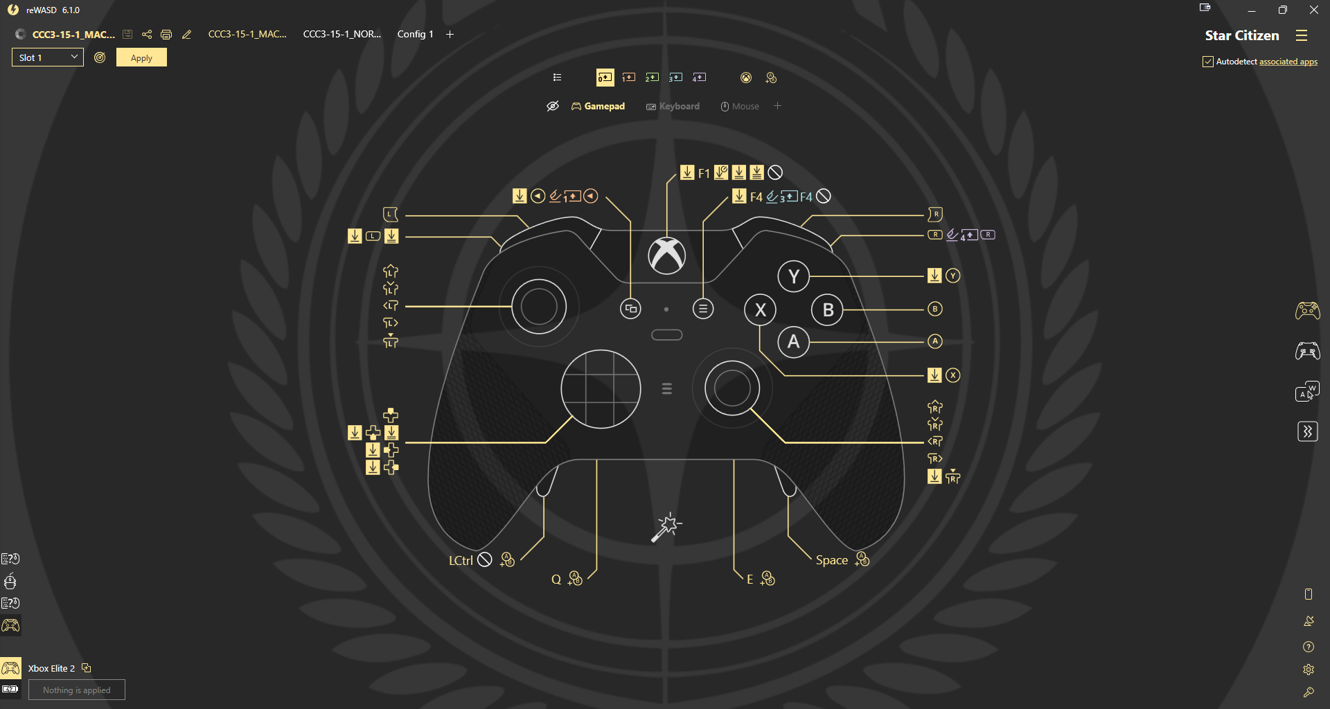

        Thank you for the information provided.
        Did you apply the config manually using the yellow "Apply" button?
        Based on your screenshot, it doesn't look like the config was applied.
          Thanks for the quick response, I clicked "Apply" and no changes to the paddles being recognised.
            Could you check the firmware version of your controller in Xbox Accessories?
              Firmware version 5.13.3143.0
              I reset the controller to default just to check that the paddles actually work, when mapped to ABXY they work just fine.
                At the moment, this firmware does not allow remapping paddles in reWASD with any type of controller connection.
                We hope that Microsoft will do something in this direction, but for now we have what we have.
                If you want to use paddles with reWASD, we recommend that you roll back the firmware to an earlier version.
