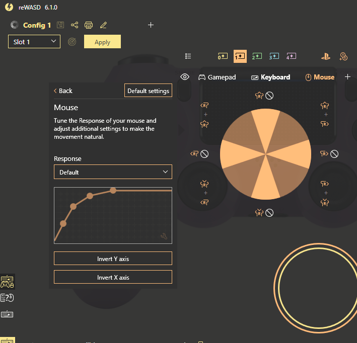

curve bug
  • curve bug
    you can see i've selected default and custom curve is still showing.

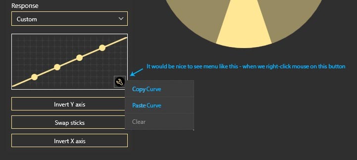

                      I also think that import export curve would be good idea. Or add a copy paste curve. Or maybe adding an import and copy option would be your best bet. Because sometimes we have different mappings on our layers that we don't want to influence.
                        Got your idea, thank you!
                        Will consider adding it soon
