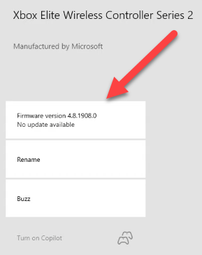

              Speaking of Xbox Elite: what version of firmware do you have on it? Version 5.13 is known to have issues with paddles and it doesn't seem like we have a working solution for that at the moment.

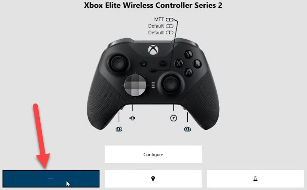

                It appears to be an issue with multiple paddles. How do I check the version?

                  Updating to 5.11 or 5.13 is not recommended.
                    Ya, it's currently 4.8, but I'm certain it's still an issue with accessories. I can fiddle around with accessories(restarting it/switching profiles) and it will begin working normally again.
                      Please ensure that you have applied the configs with unmapped paddles in Xbox Accessories app for all three Slots. It may be a chance that some of the slots still have XYBA mappings, and so the controller doesn't work properly when you switch to them.
