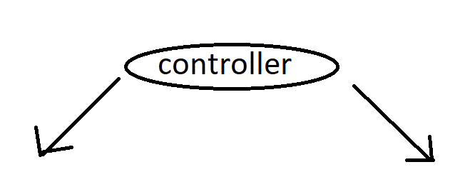

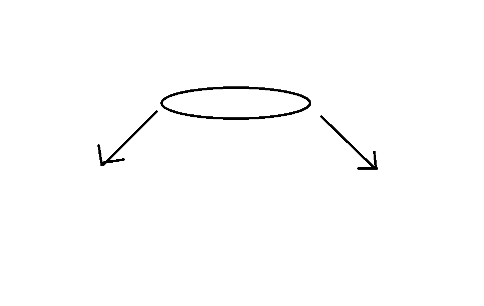

      this is what i meant by 45 degreee between Left & Down, it always only detects as Left.

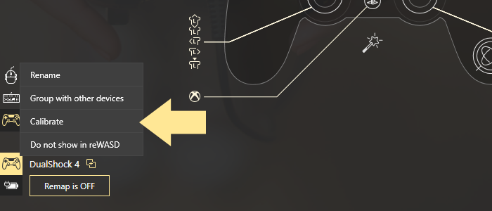

        Try also to perform manual calibration of the gyroscope.
        Then unclick Auto-calibration, and press Next. Place your gamepad steady in any position, the most important thing is not to rotate or move the controller while reWASD is calibrating it. Click Next when ready to calibrate.
