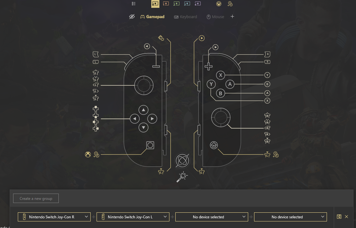

    Also, could you please make a screenshot of your group with opened config? Need to see exactly how the devices are grouped, and which mappings are involved. Thanks in advance!
      Yeah it's the current build. Updated like 3 days ago due to another issue.
