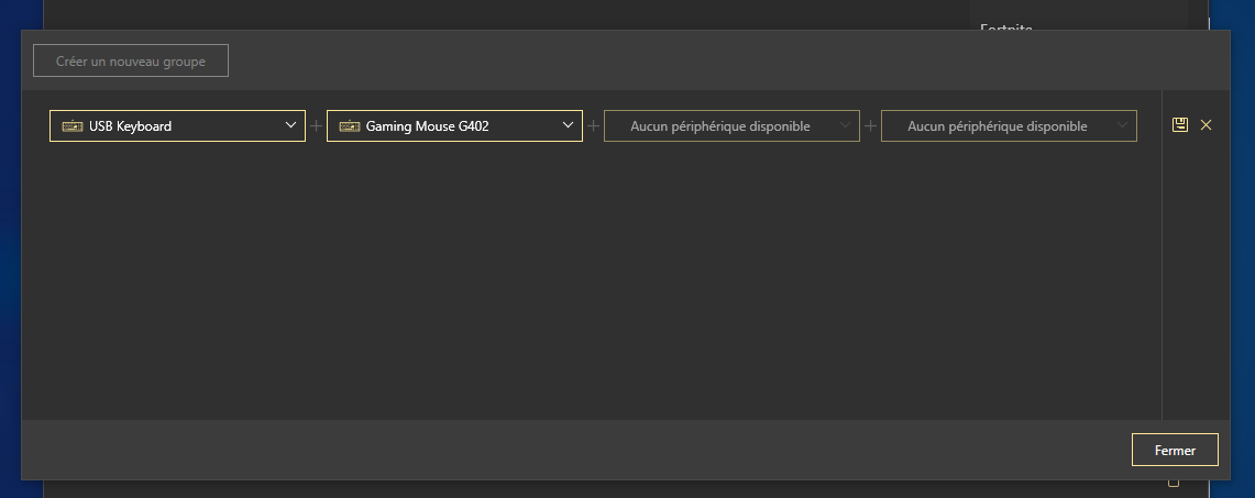

    hiho,
    i try to put my mouse in rewasd, but dont look like working (same in game)
    it look like rewasd detect my mouse like a keyboard, why? and how to fix this problem?
    so when i try to use it in game, it doesnt detect my mouse movements like controller movements, its so strange, it worked well with my old mouse (10€ random mouse)
    thanks in advance
    You need to activate re-initialization from the context menu of your mouse. Here are the steps:
    1. Remove the group (in this window, press the "remove" icon at the right)
    2. Choose your mouse as an active device
    3. Press a right mouse button click to activate the context menu
    4. Choose Re-initialize option, and submit it as a mouse
    Here is a video that describes the steps above.
      hi,
      working well, thanks!!
      have a nice day
