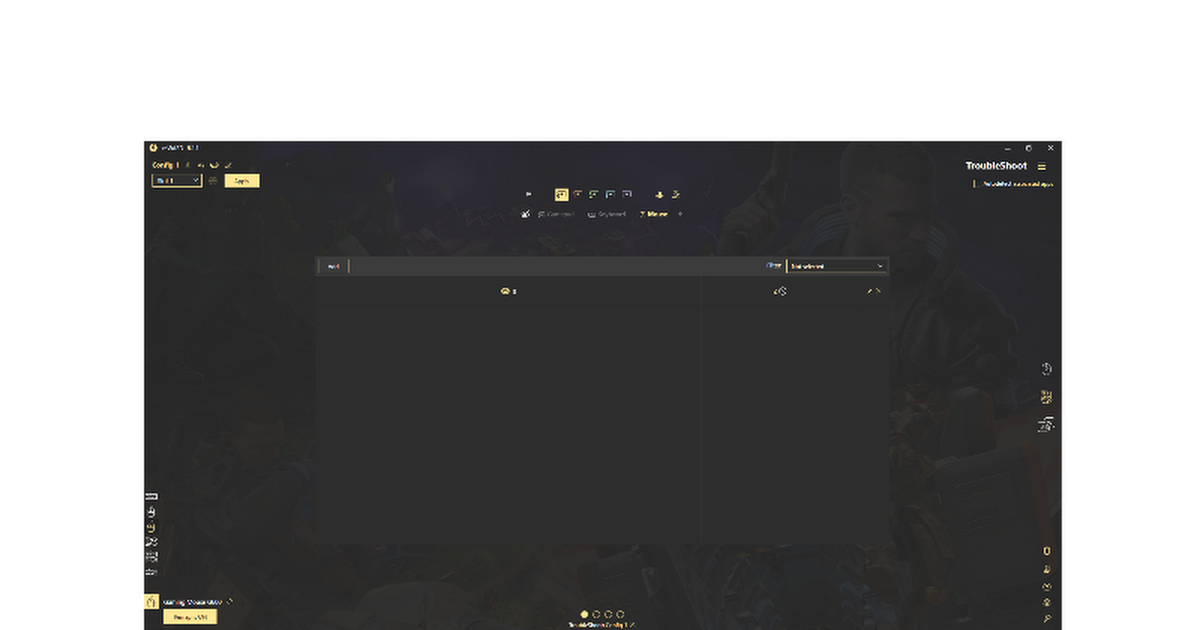

    Please send a screenshot of the full reWASD window with your mouse mappings, and also send a screenshot of the bindings from G-Hub.
      Here you go. Also embedded a short video demonstrating an interesting finding while troubleshooting— once GHub is closed, buttons are "intercepted" by reWASD properly. Of course that has its own limitations (native scroll right and left don't work without GHub running), but thought that might help in the troubleshooting.
