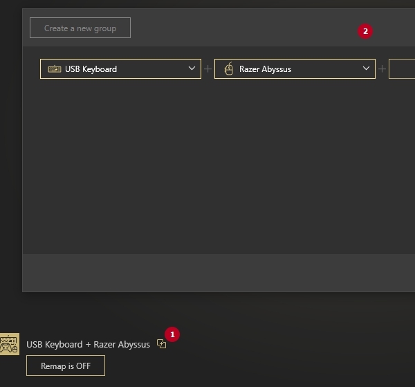

    Could you please show me the screenshot of your group? Something like I have here:

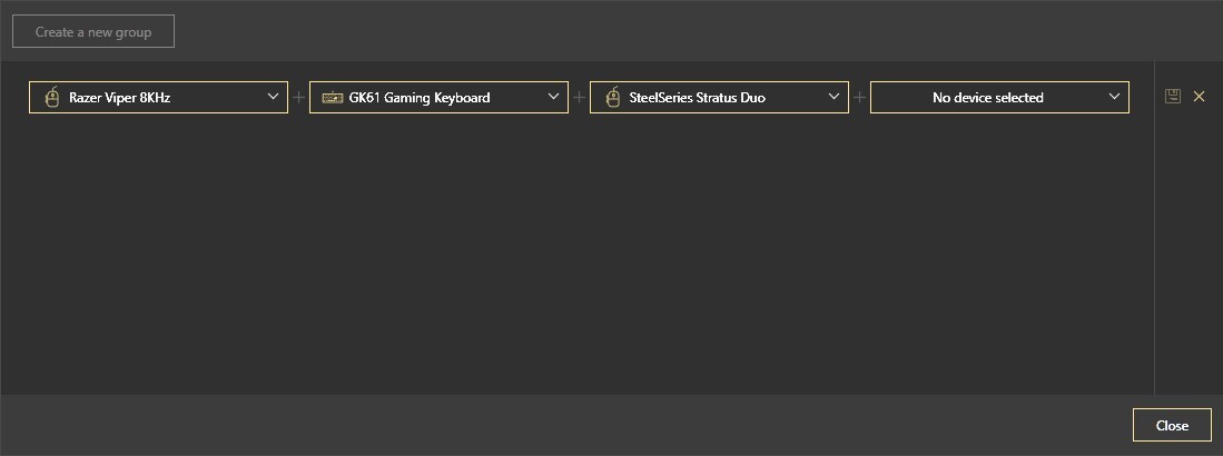

      This is what my current group looks like. Ive tried Removing the Steelseries Duo, Which is basically just an xbox controller but made by steelseries, Ive also tried an actual xbox one controller wired to the pc instead of the Duo, But this setup works for every other game ive played FPS wise.. Splitgate, COD, Halo infinite, obviously just using a different control scheme based on which game i play.
