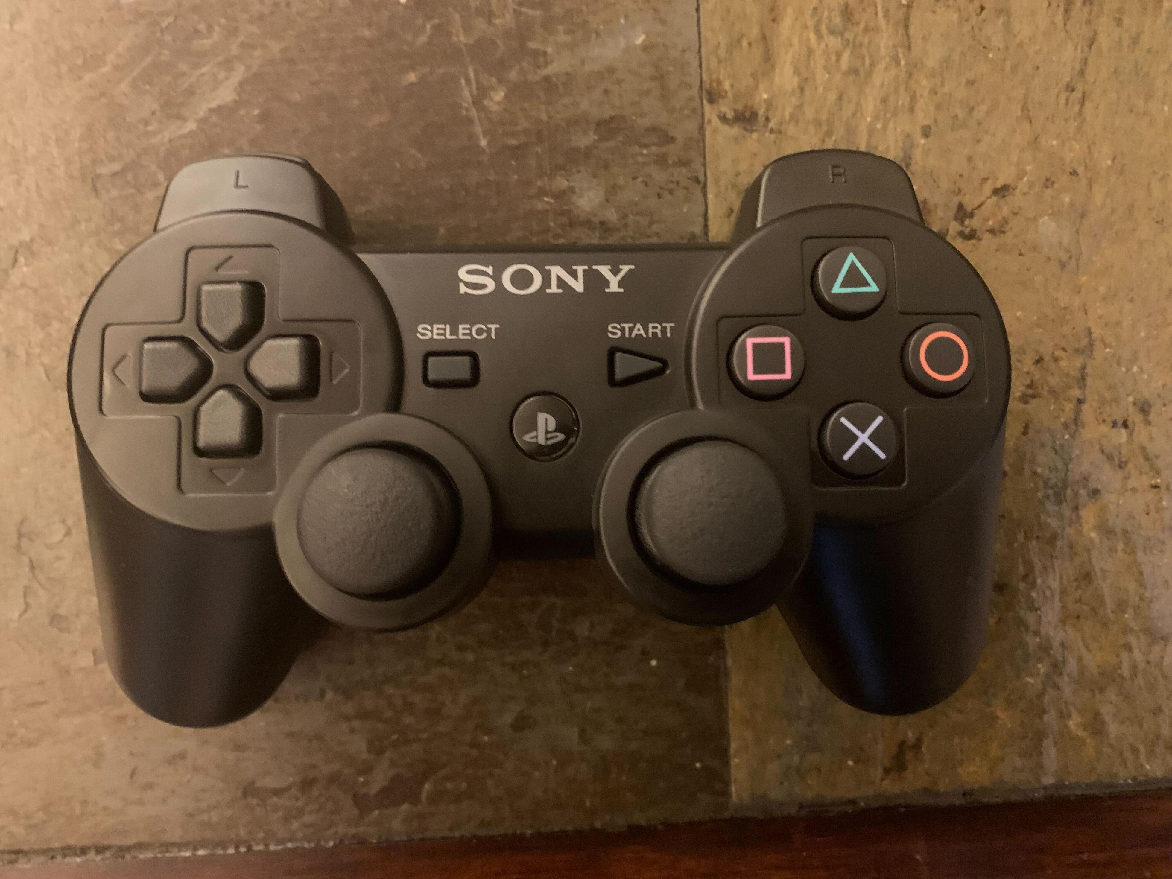

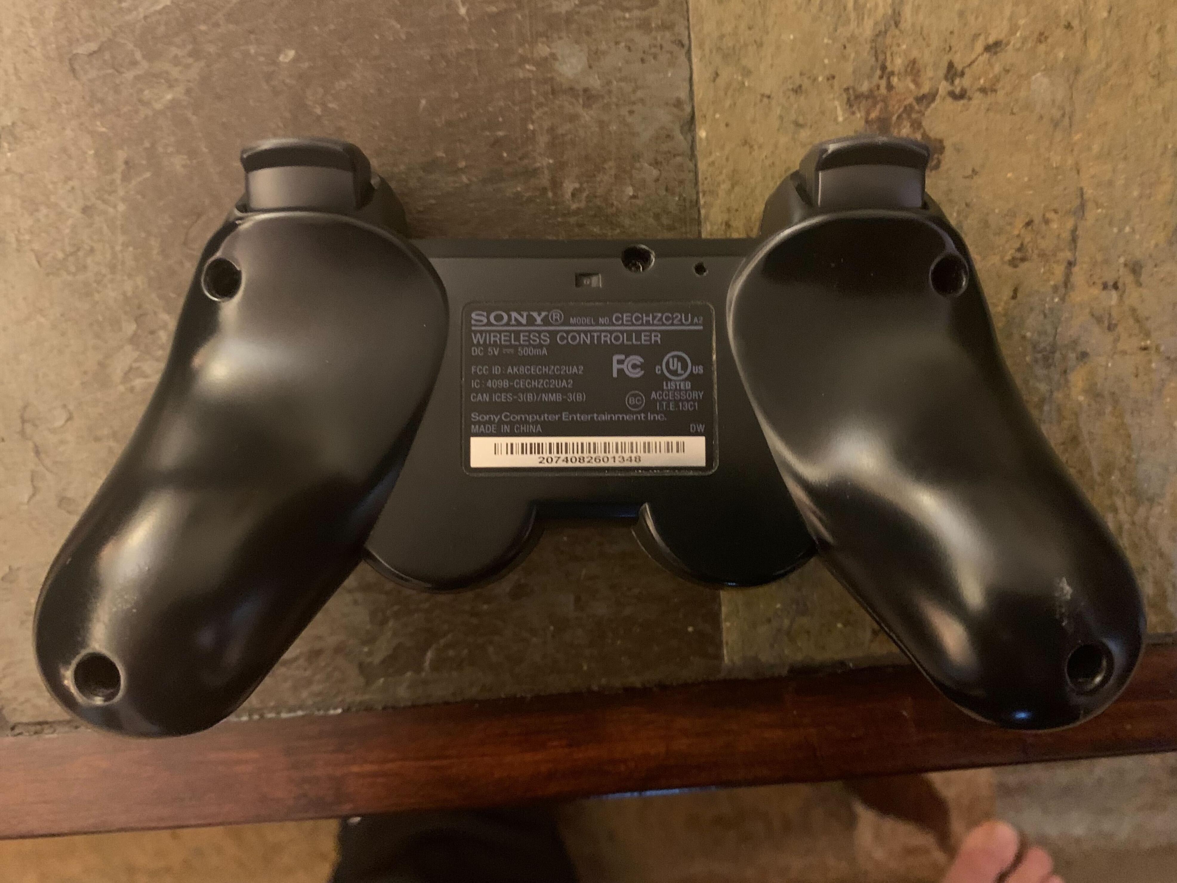

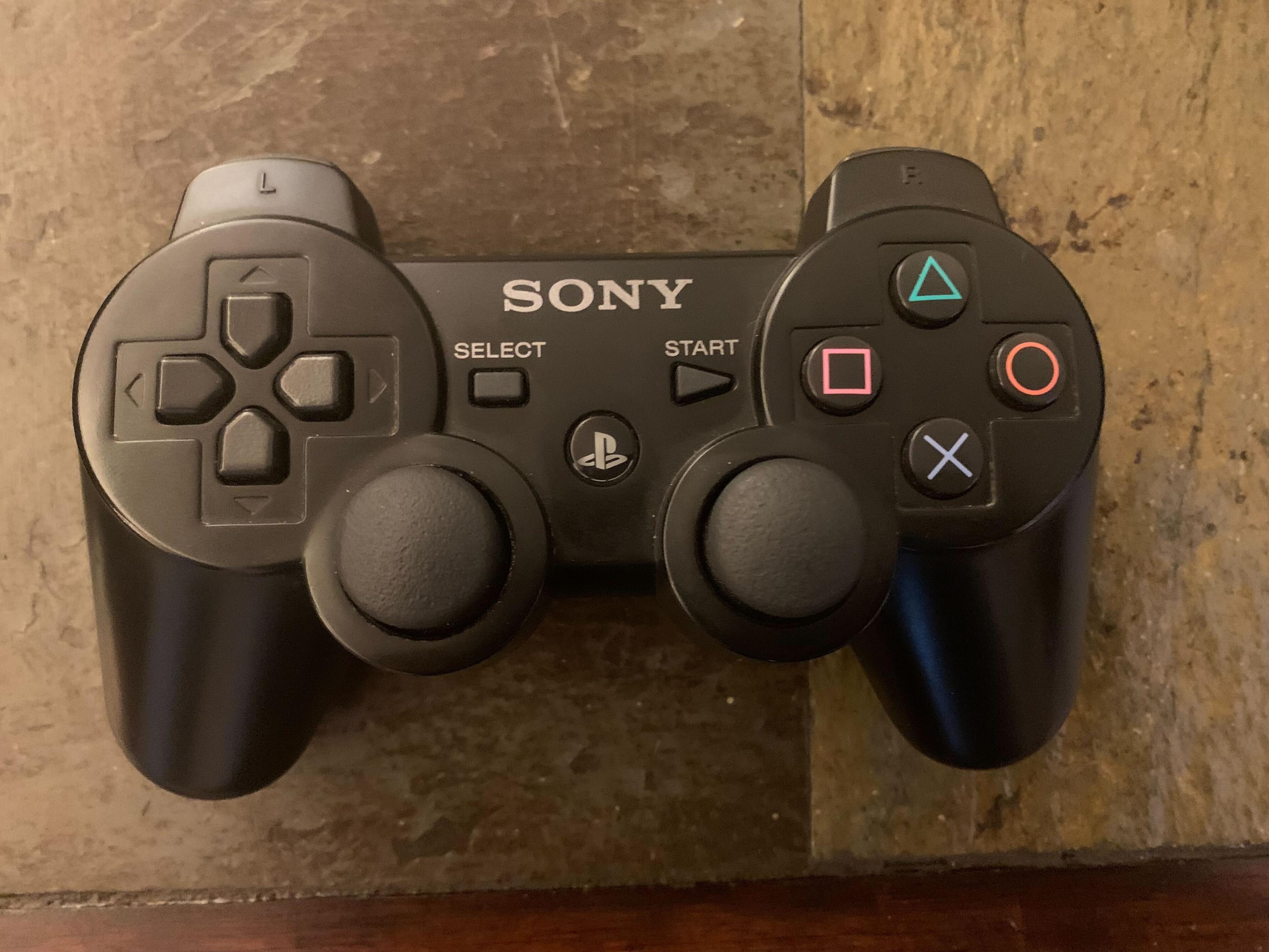

  • Cuzzin Chizzy
    replied
    to clarify, the refurb rumble works on the PS3, but wasn't working on the PC
    Leave a comment:
  • Cuzzin Chizzy
    replied
    thanks for your help checking into all of this you guys
    I tried turning off Xbox Extended Feature Support in Big Picture, restarted my PC and tried again. Getting the same results there.
    Now I'm starting to think I've been duped though. I just bought a used/refurbished controller from a local used game store that usually has legitimate products. The controller seemed legit and didn't have anything that screamed fake. The rumble works, the sixaxis tilt works perfectly, and the controller feels pretty good.
    After having these issues though I started trouble shooting thinking it was an issue with this controller, even though everything seemed to be working right, maybe something somewhere wasn't. So first I started comparing it to the DS3 that came with my slim with PS3 games on my Slim console. The refurb felt ever so slightly lighter, and i noticed that the rumble also felt a tiny bit different. At first I chocked this up to reading about how later versions of the DS3 had removed some extra plastic inside and were lighter. But then I also noticed the label on the back, while at first glance looks like it could be legitimate looks vastly different from the OG DS3. I thought maybe it was a european controller. The model is SECHZC2E (Europe?). where the OG model is CECHZC2U (US?) Then I tested for analog face buttons, and the refurb unit doesn't have analog function in MGS2 HD but the OG does.
    The last thing I tried was unpairing the OG DS3 from my Slim and pairing it with the PC and reWASD. I noticed a difference right away in that instead of all 4 LEDs flashing and staying lit after connecting like with the refurb, only the player one LED flashed and stayed on. Then rumble was working in reWASD and in games.
    So now I'm pretty sure that the refurb is a fake controller. But maaaan, it's VERY convincing in the feel of it. I'd almost want to keep it even if it was fake if the rumble and analogs worked like they were supposed to, because everything else about the controller feels good.
    I should have thought about this before reporting the issue, but had no idea there was such a huge number of fake DS3 controllers out there. I guess it makes sense since they aren't sold new anymore.
    Unless there's an off chance that it actually IS legitimate and just a later model released in Europe, and doesn't play the same way with windows as a US one......? I mean there were only a few games that used analog/pressure sensitive face buttons, before developers kind of dropped the feature, so maybe they just left analog out of future revisions?
    OR..... It's just a phony. A reaaaalllly convincing feeling phony.
    guess if I want an extra controller I might need to pay $100 dollars for a real one on eBay... eesh
