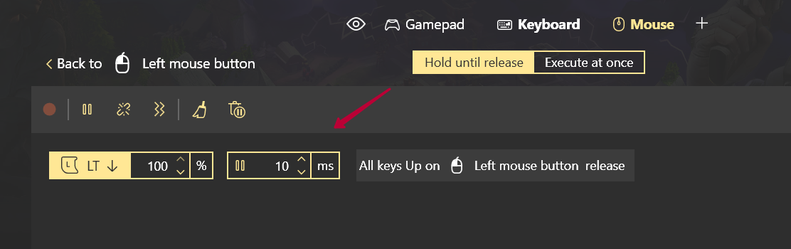

                    Since we have added Combos for Start and Release activators in reWASD 6.2, you can use Turbo for your stick moves (the combo should include sticks only, no need to add L2) and set L2 as a Hold until release combo with a small technical pause and map it to Start activator. This way, it will work as if it is emulated on the Single activator but together with the mapping you saved to it.
                    Click image for larger version  Name:	d18b009db1.png Views:	0 Size:	99.5 KB ID:	232154
