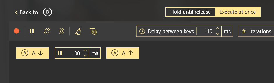

    You may try to solve the issue by replacing a mapping on the Single Press activator to the combo with the same button and pause in the middle. Something like I have here:

      The suggested combo action seemed to make it a lot more reliable. It still misses sometimes, but that may be an issue with my controller. (an SN30 Pro Plus) But in case it helps anyway, I'll provide more information.

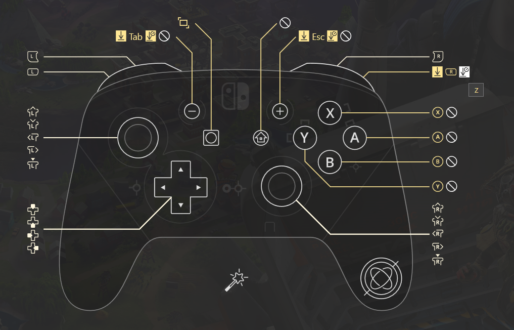

      Just in case, I'll post a picture of my bindings.

        Pause gives game the time to detect the pressed button and it seems 30ms is not always enough, so increase the value to 50ms or more until it works consistently.
          50ms seems to be the sweet spot, as its so far completely consistent. Thanks for that!
