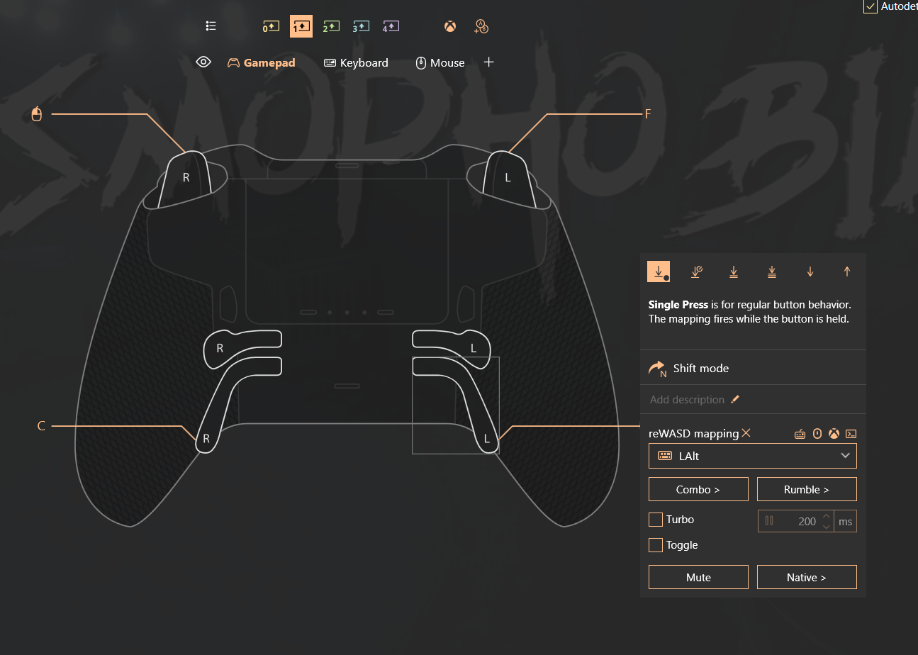

    I use a Xbox Elite 2 and I want to use one of the back button (while holding) to change the sensitivity of the mouse and reset it back when I release the trigger. It helps me to be more precise when it comes to pick up things.
    I tried using the "shift layer" but changing the mouse settings change it for all my layers. I'm really new to this software and have been using another product for years, so I'm a little lost on how to set something so easy

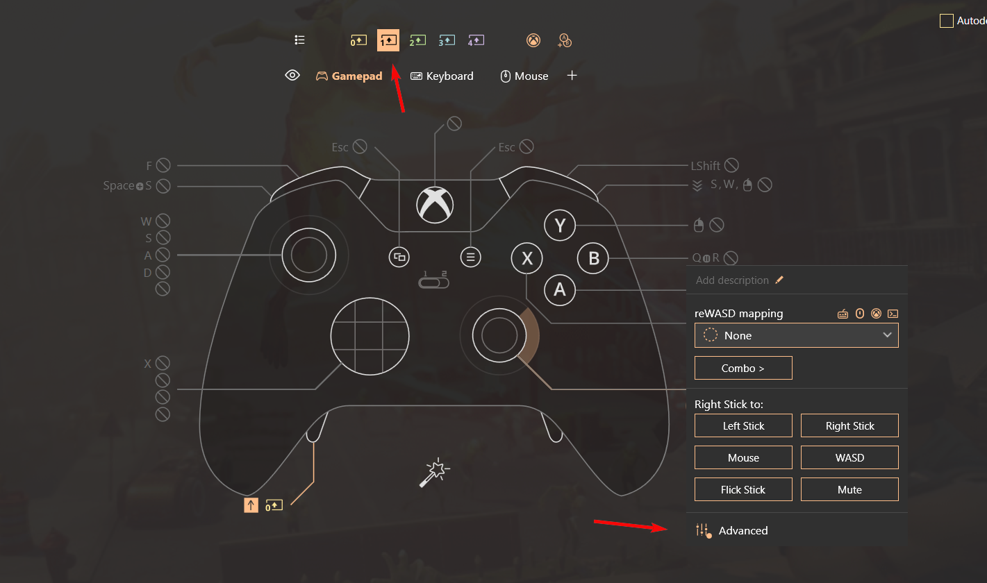

    You should adjust the response of the mouse exactly in the shift layer settings which you use while holding the shift activator.
      Thank you for your answer. if I don't see the "Advanced" section, what do I need to activate ?
        Ahh nevermind. I just figured out the mechanism. By pressing the Shift modifier button, I get the new layout in which I can modifier my right joystick (mouse). Thank you.

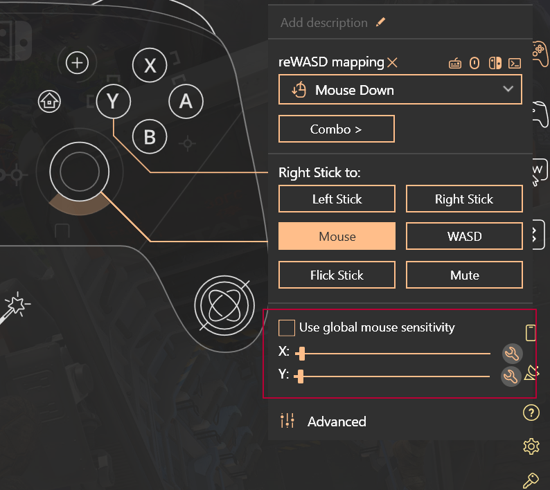

          If you are using the mouse mappings on the stick, you can also change the mouse sensitivity for this stick inside this Shift layer only. Here is where you should change it:

            Exactly, you're right. I was looking on the button section and not the right stick. I understand now ! Thank you very much for your help.
