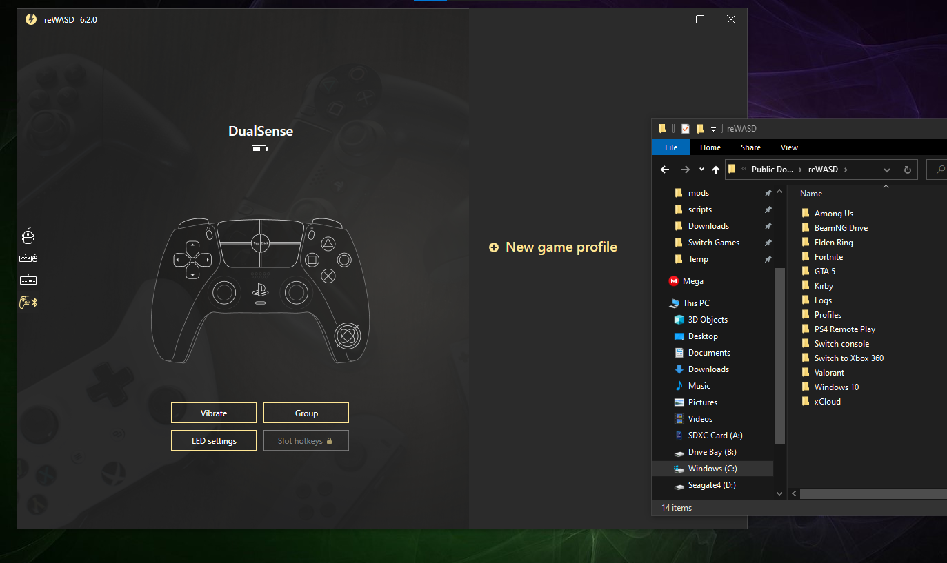

      yes, they are there but the app saids "New game profile" it was find on the last version.
        Could you send a screenshot of the contents of the C:\Users\Public\Documents\reWASD\Profiles folder and a screenshot of the full reWASD window showing what it looks like in the interface?

          Heres the picClick image for larger version

            Thank you. Please go to → My data.
            The path to the profiles that is indicated there matches where your profiles are actually located?
            You can also check this by clicking on the Open folder location button.
            If yes, check if there are configuration files in these profile folders (make sure these folders are not empty).
              odd, it will not let me open preferences. also there are .rewasd and .rewasd.bak files in the folder
                And when you create a new profile, do you have the option to go to Preferences in the bottom right corner of the app?
                  I made the new profile. still will not let me, Is mine bugged or something.
