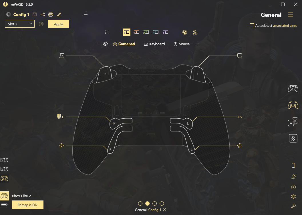

      Included is the screenshot of the paddle maps, lemme know if you need something else.
        Hopefully I don't get in trouble for this. But it says my post was unapproved, I think because of the attachment.
        I just ran the updater in Xbox accessories earlier, so theres no more updates there (it says that as well in the accessories app.)
        Heres the paddle bindings:
        [link expired]
          Most likely, you have received the latest beta firmware.
          The latest beta firmware (5.13) makes it impossible for us to detect paddles as independent buttons. The only solution we know of so far is to roll back the firmware to the stable (4.8) version.
