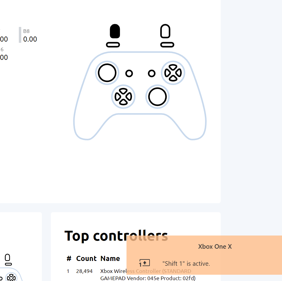

    Currently, I could not reproduce any other mentioned issues if I do not set a big Shortcut Press Time — the keys are pressed immediately in the tester. Same for LT: it works as a trigger even while it activates the Shift layer:
