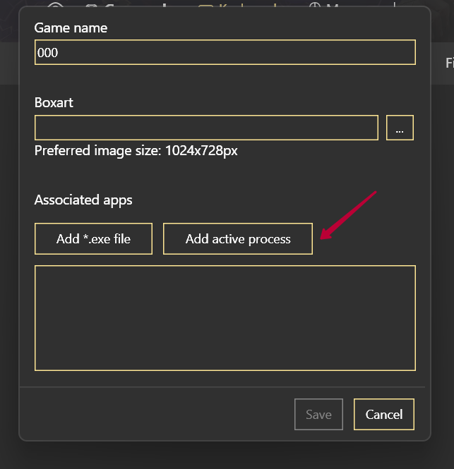

    Please try to check processes instead of the exe files for Windows Store game. Launch the game and try to find everything that is related. Indeed, the exe files are hidden in the system if you use the games from the store, so it would be easier to find the correct one with Active process option:
    Click image for larger version  Name:	7e78f6bd64.png Views:	1 Size:	30.4 KB ID:	232351
      That's how I added KillerInstinct_UWPx64_r.exe, Cuphead.exe, etc to the Associated apps.... It's also the same way I've added all of the steam games. Steam games seep to launch the remaps fine, just not the Windows games.
