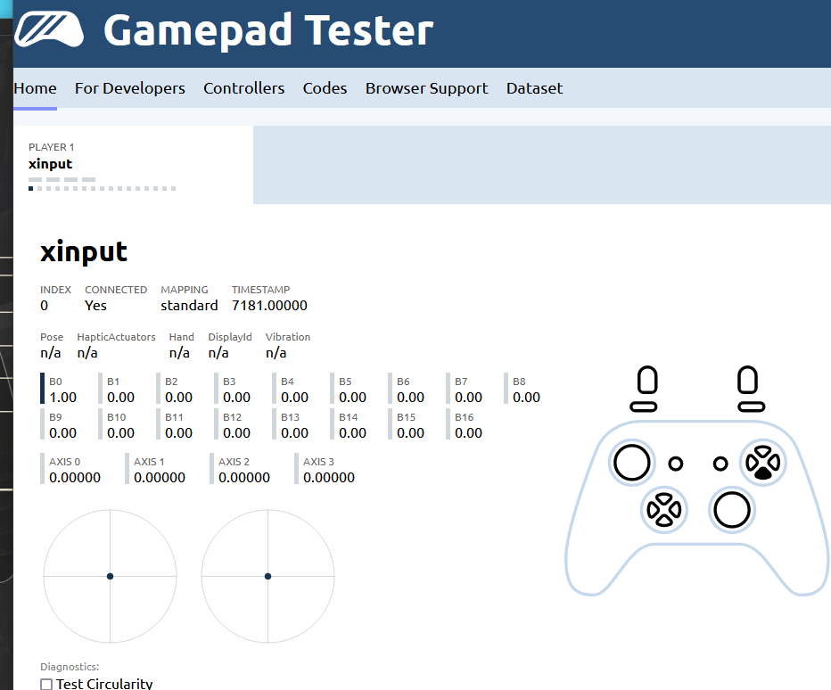

        It looks like the turbo is set up correctly in your case. While you hold down the right stick click, the Xbox controller's virtual A button fires with a 100ms pause. You can check it out on the gamepad tester. If everything works in the tester, but the game does not detect this input, try increasing the pause in the turbo.
          thank you for the reply.
          "gamepad tester" doesn't work (gamepad detected but no reaction).
          increasing the pause doesn't change anything.

            Does the gamepad not respond at all in the tester, or only when checking turbo mapping?

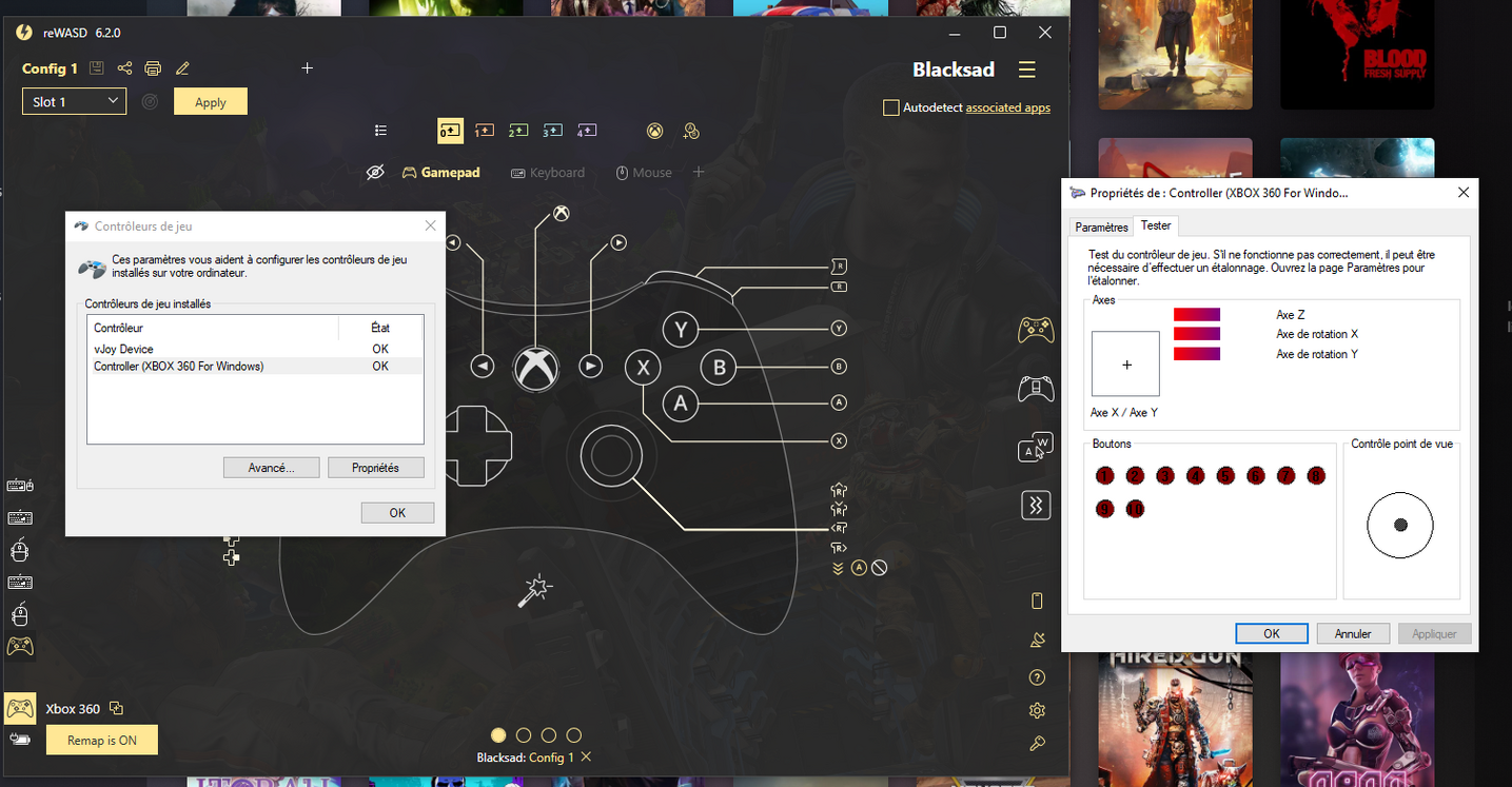

            Do the following:
            Apply the config. Then please enter joy.cpl in the Windows search and send a screenshot of how your controller is detected in the opened tool.
              in "gamepad tester" nothing appens when i push a button
              in the windows tool i see the autofire in function (need do put 10ms to have it faster then my fingers - i'm pretty sre that the clock is not correct)

                Did you run the gamepad tester after applying the reWASD config or does nothing happen even when reWASD is turned off?

                    yes "gamepad tester" with rewasd on and off
