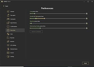

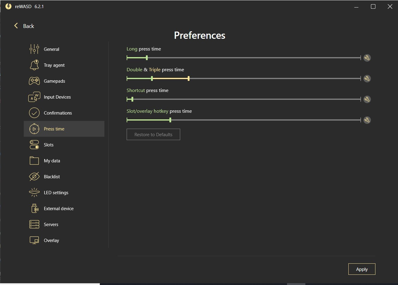

    You can adjust press time in Preferences. Or are you meaning another kind of delay? Have you faced delay when emulating a keyboard to a virtual controller? Please provide more details
      There is no lag when simulating the virtual controller with the keyboard, but there will be lag after switching the layer to the keyboard. I have tried to adjust the decision time, and the lag will be the same after adjustment.

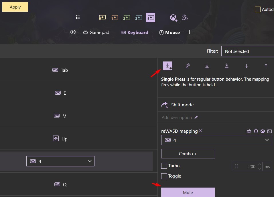

                    As I see in your Shift keyboard mappings are assigned to Start press. Try to assign them to a regular press and add a Mute like this:

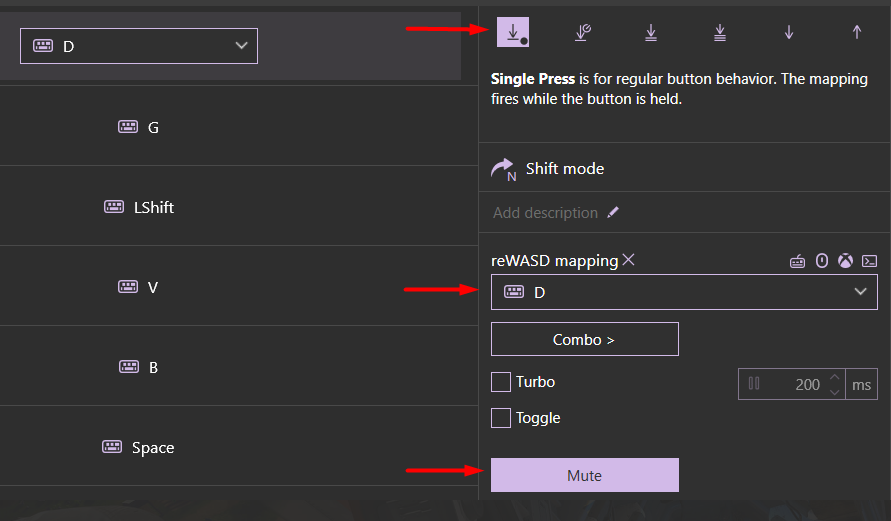

                        Hello! This is a follow-up regarding your request. We tested it and confirm the previous advice. In the configs on the Shift layer 4, the mappings are assigned to Start press and without Mute.
                        Because of this, each key has two inputs, which causes a delay in the game.
                        To avoid this, mappings should be assigned to the Single press with the Mute. This way the game will only receive one full click.
                        The problem appeared in 6.2.0 due to technical changes in this version. It will be corrected in the future updates.​
