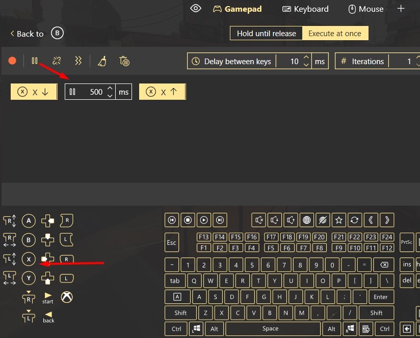

    What I'm trying to do for example is, in warzone on controller you have to short press x for crouch and long press (the same button) x for prone. With rewasd would it be possible to maybe remap one of my paddles to trigger LP x with a regular short press?
    Hello! This can be done with combos. Create a combo on the button, then add a press of this button and a short pause before releasing it.
