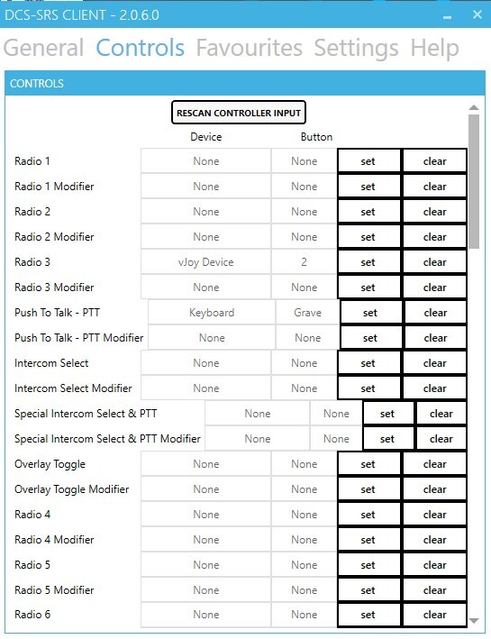

    I'm using DCS-SRS and it has a screen where one can register the inputs linked to program actions:
Name:	2022-07-23 10_18_53-Clipboard.jpg
    I've setup a profile in reWASD for my XBox One Elite controller, so that "big right paddle" + "left POV" emulates the "F15" key.
    But when I press the "set" button in DCS-SRS interface, and then press"big right paddle" + "left POV", it detects the actual buttons on my gamepad and stops listening before even registering the F15 key.

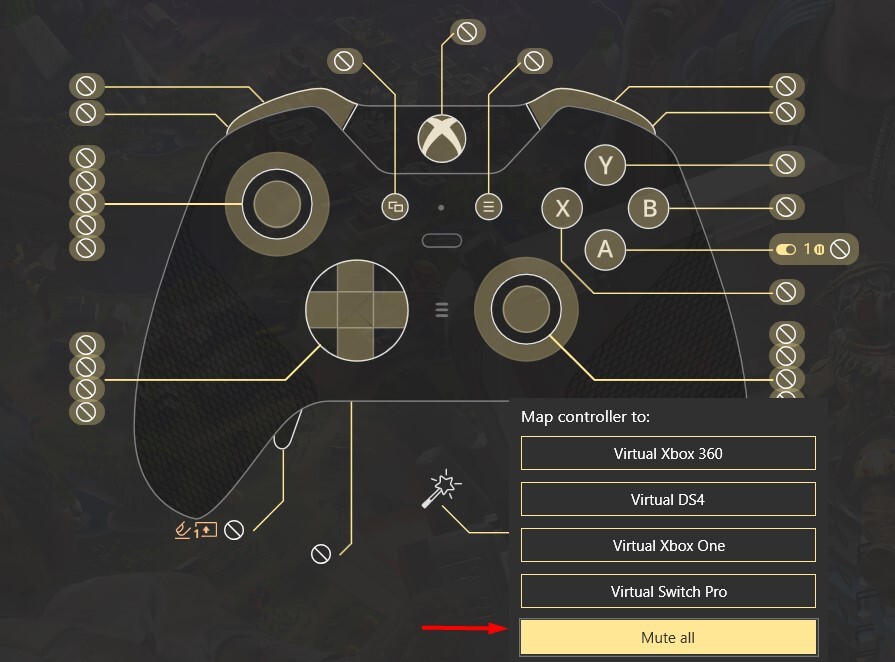

        Try using the magic wand and assign Mute to all the buttons on the controller.

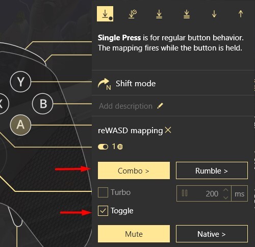

        Also, to make the turbo work on pressing the button instead of holding it, use the Combo and the Toggle checkbox. You can adjust the frequency of pressing the button using a pause in the combo.
