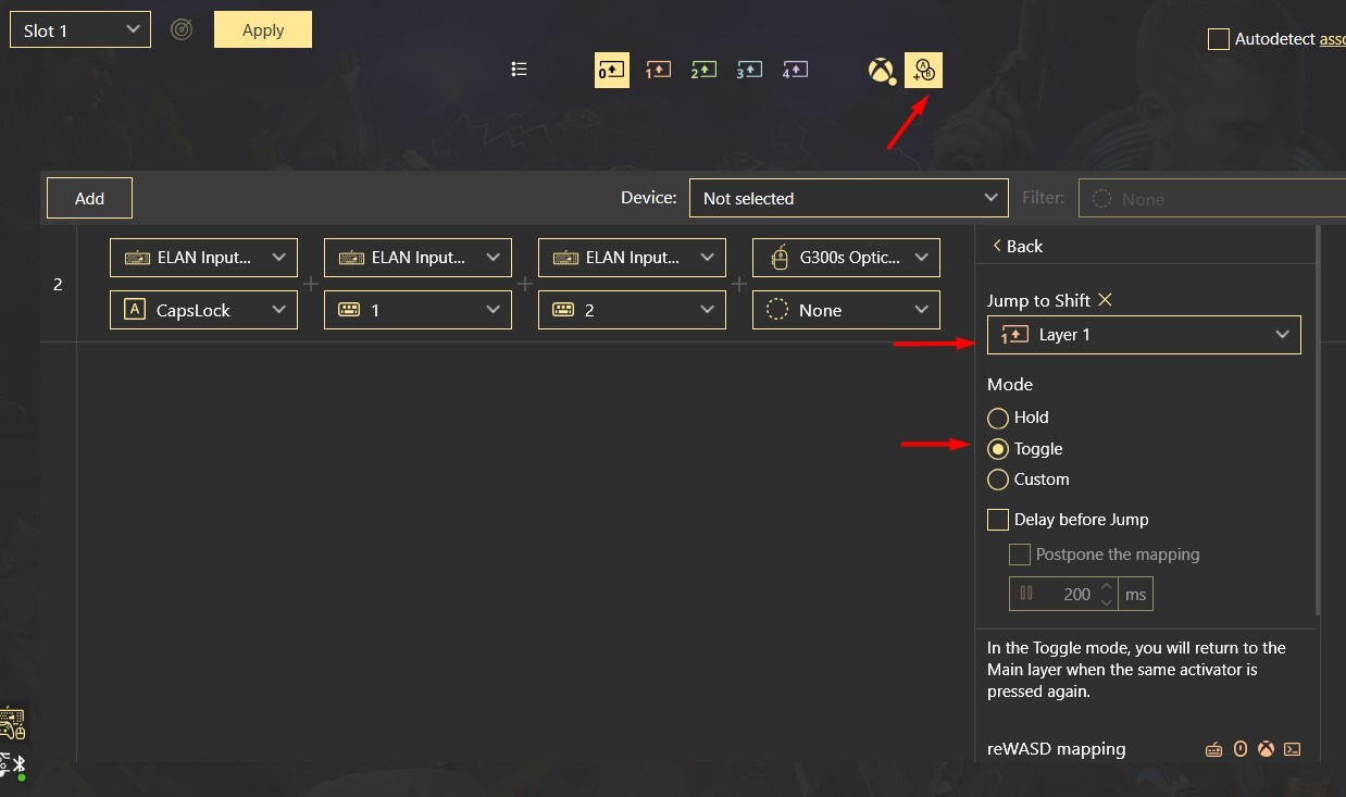

    Is it possible to configure hotkeys to switch slots differently for different profiles? For example, I've been using Alt + 1/2/3/4 for a while, but for one game in particular, I'd like to change it to something else.
    Otherwise, is it possible to setup hotkeys to change profiles with a shortcut or have a shortcut to go to next / previous slot?
    Hello! This cannot be done, because profiles with configs are placed in Slots when applied. Slots are not located inside configs.
    In your case, for this game, you can use Shift layers if they are not used for other purposes, and activate them using shortcuts.
      I already use the layers for something else.
      Is it possible to have shortcuts or combos that change to particular configs then?
        At the moment, the only option is 4 Slots and Shift Layers.
        We'll think about how it can be improved.
