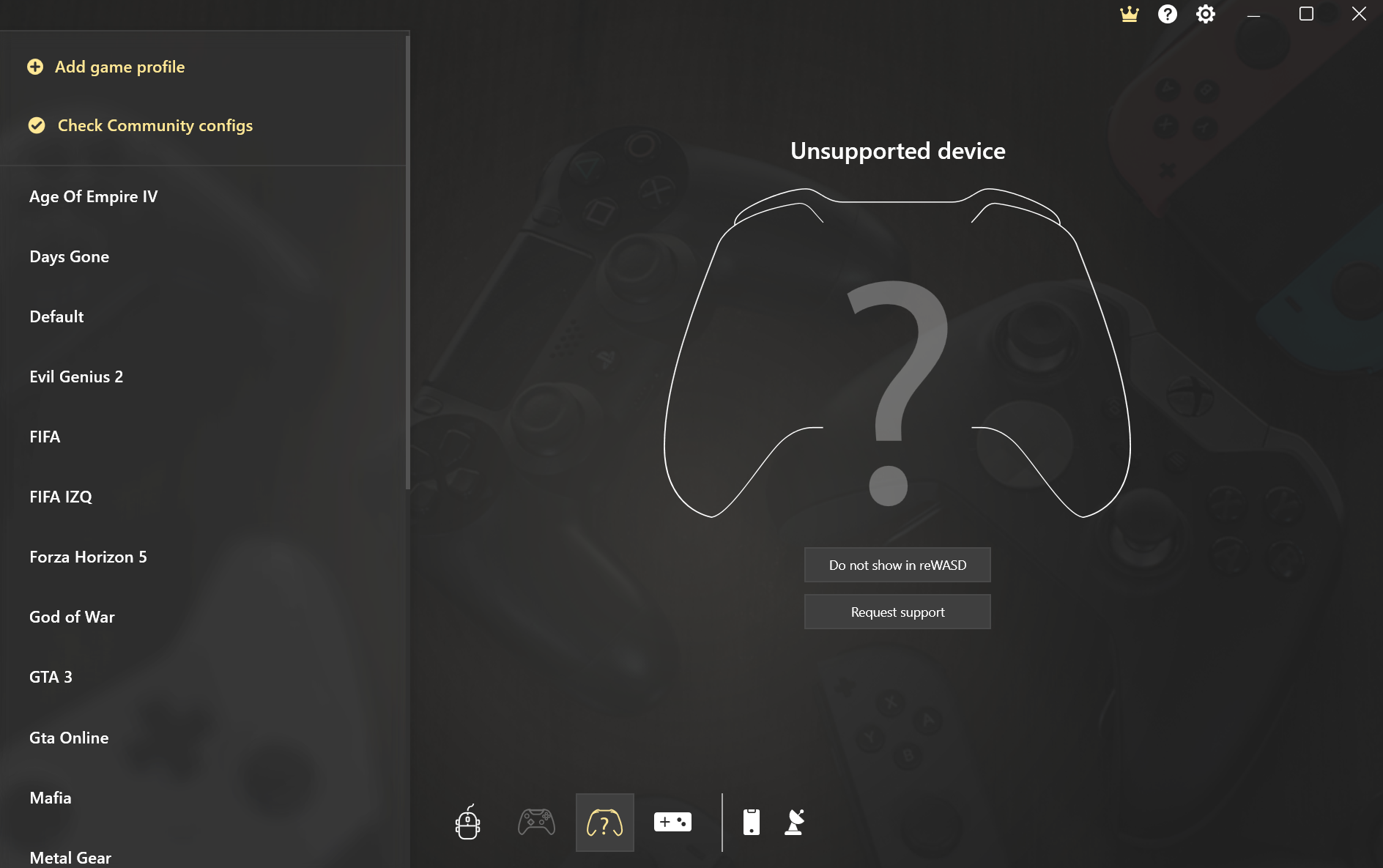

    Just got rewasd 6.3.0.6721 but my fully functional in 6.21 version xbox controller with firmware 2.3.2385.0 is now unsupported, can you please help me?

          Same issue again, please help
            I have two of the above mentioned controllers, but rewasd only works with the first connected, the other is unsupported

                  We will look into this. For now, we suggest either staying on the older version or trying to physically reconnect and re-pair all dongles and controllers after updating to reWASD 6.3.0.
                    Reconnect every device and reinstall after uninnstalling and nuke every last reg key didn't work, i will stay on 6.21 for now, thanks.
