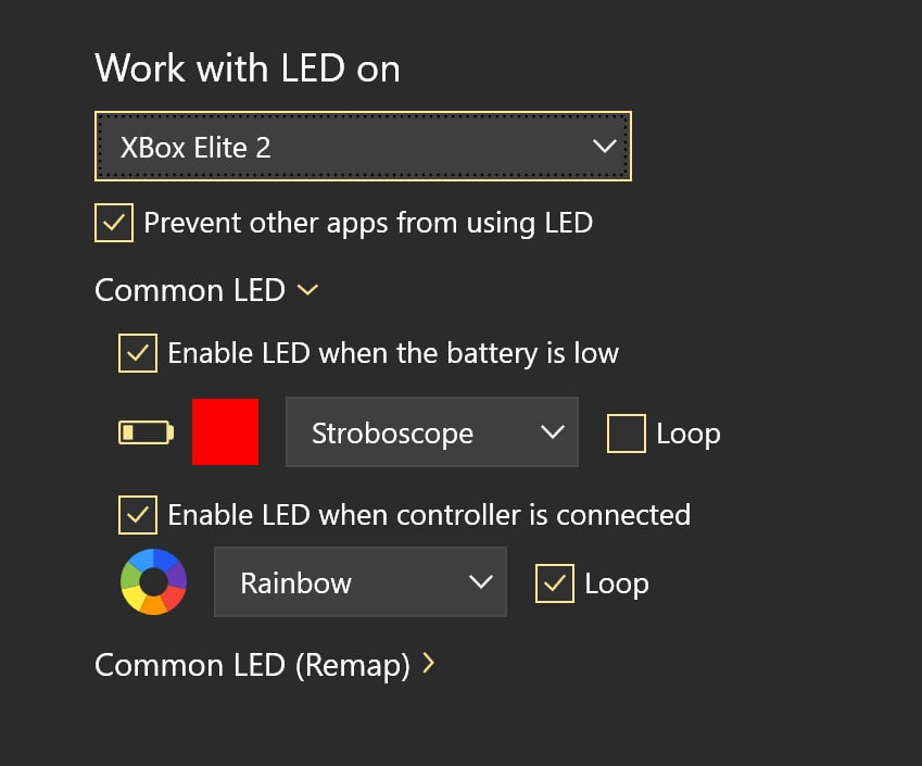

    1. XBOX One Elite V2 - LED is off
    Description:
    If i uncheck both Boxes in Common LED, the LED of the Controller is off.
    Before 6.13 the LED shows the setting from the XBOX-App (brightness)
    My wish:
    Let the LED shine if the boxes are not checked.
    2. XBOX One Elite V2 - LED is not white
    Description:
    This is also before 6.13. If i select the Color "White" (RGB: 255, 255,255), the LED glows light red.
    My wish:
    Anyone a idea how to make the LED white? Like the Original-LED-Setting?

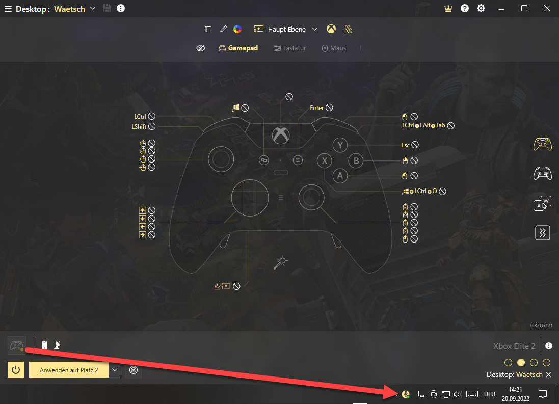

    3. Disconnected Controller and Tray Icon
    Description:
    If the Controller is disconnected, the Tray Icon still shows the "reWASD"-Dot with Green.
    Before there was a "Unconnected"-Icon.
    If i click "Hide until reconnect" the old "Unconnected"-Icon is there.

    1-2. Please note that reWASD works with LED on Xbox Elite 2 only with wired or Xbox Adapter connection. Probably, the reason is in the type of connection.
    3. If the device is online and remap is applied there is a green dot. The offline device is marked with a yellow dot. If remap is off - gray. Please provide us with a screenshot if a disconnected device shows a green dot. We will try to reproduce it from our side.

      1-2: I'm using the Xbox Adapter
      3. Please see Screenshot.

        Understood.
        Try to uncheck Prevent other apps from using LED​ option.

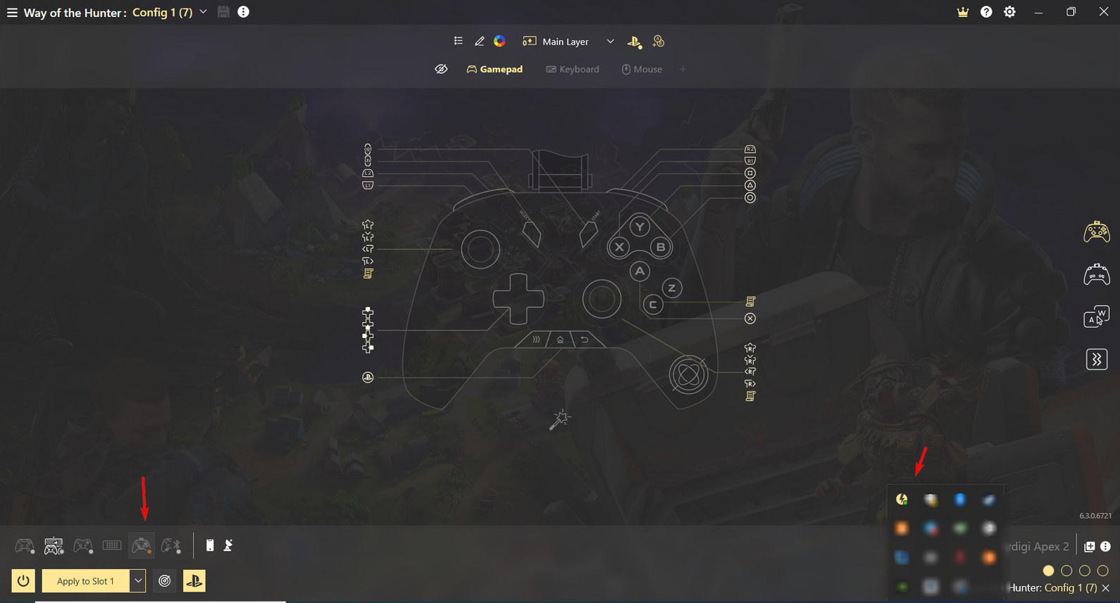

        Hmmm, the Green dot is in the tray even if you apply an offline group. So, I'll talk about it with our team.
