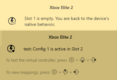

Actual result: after saving new mappings to slot, changing slots give me message "Slot X is empy. You are back to the device native behavior." and I cannot change mappings on any other slots outside the one I modified because all the UI elements wanish

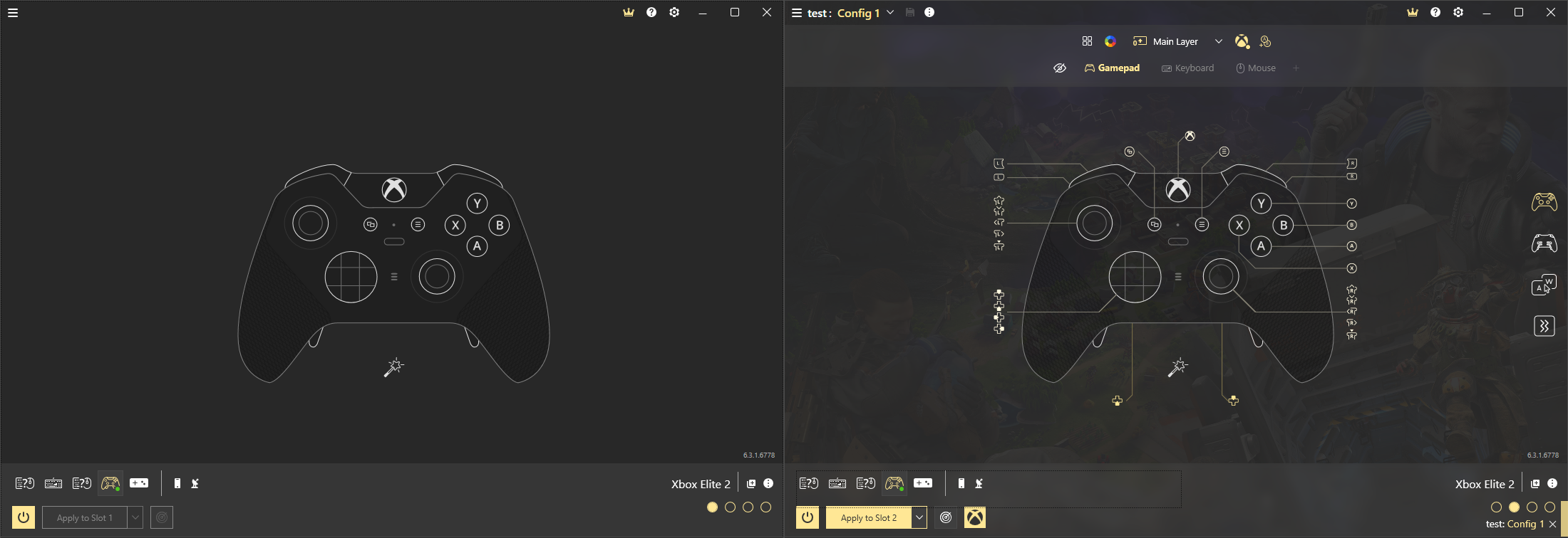

And after mapping the paddles to buttons on slot 2 and saving it, I switch to slot 3 so I can map the paddles to keyboard buttons. Then I get the message that the gamepad changed to its native behavior, all the buttons wanish from the UI. This means I cannot change anything on the gamepad on any other slot outside the slot 2 that I just configured. I can click on the arrow nex to the apply button and change it to slot 3, but that will only result of whatever was done on slot 2 will transfer to slot 3 and I cannot do anything on slot 2 any longer.
So after changing something and then saving it to the slot it will result to this:
slot 1: device native behavior, cannot change anything
slot 2: custom mappings
slot 3: device native behavior, cannot change anything
slot 4: device native behavior, cannot change anything
Downgrading firmware from 5.13.x to 4.8.1908.0 didn't help.
Computer that I'm trying to do this on doesn't have Xbox Accesories App or active Steam Enhanced Xbox support.
