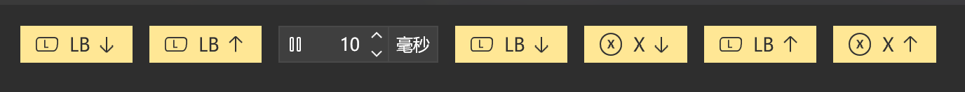

    Now I am trying to split a long process: LB↓ (n*X) LB↑ into n*independent (LB+X) operations.​ In other words I want the mapping:
    LB + (X, X, X, ...) => (LB+X), (LB+X), (LB+X), (LB+X), ...
    My current idea is to reset the LB button by a quick release when X is pressed in a shift layer:
Name:	2022-10-01 172849.png
    However the "releasing of LB" is not working​ - I think it's because the LB is physically held so all commands of LB are overridden.
    So is it possible to "force release" a physically holding button in the scripts? Do you have any suggestions on achieving this mapping? Thanks a lot!

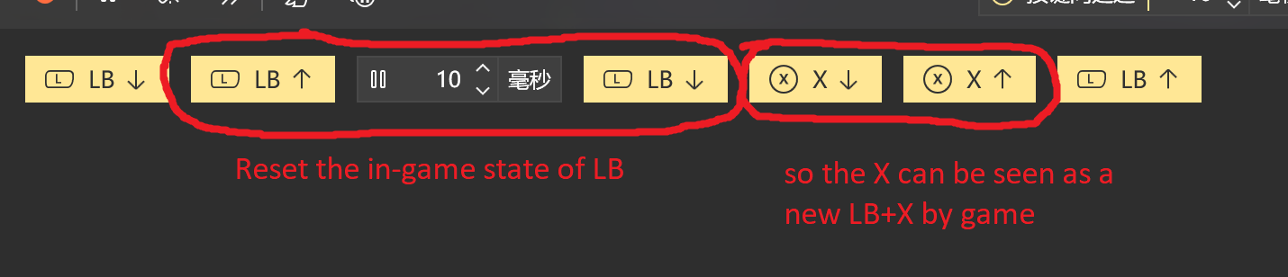

      Yes! sry for the unclarity
      In some games, the game will drop the modifier key flag (like LB) after the key combination (like LB+X) is triggered. Then if I press X again at this time, although I am physically holding LB, this X will be regarded as a separate X rather than LB+X, as the LB flag is dropped by the game.
      To trigger LB+X again, I need to first release LB, then hold LB again to reset LB's flag, then press X. I hope this can be done automatically.
      So my current idea is: with LB being held, every time when we press X, firstly we reset the in-game flag by forcing LB to release for a short time, then emit the actual X. So the game will regard this X as LB+X.​
Name:	2022-10-02 000310.png

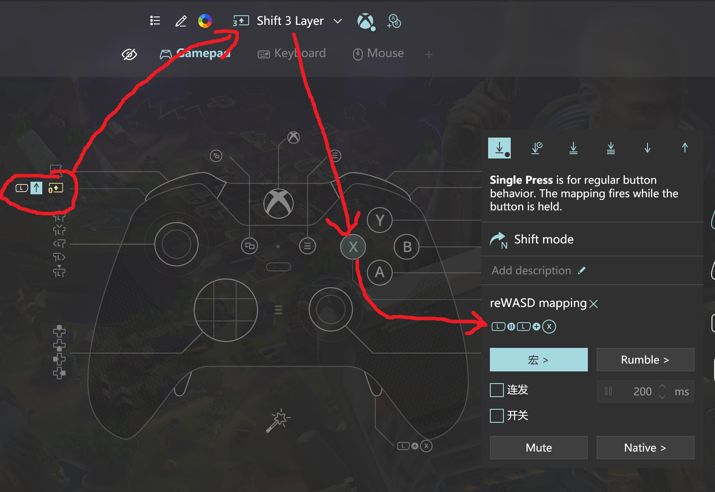

      This script is for X in a shift layer triggered by LB:
Name:	2022-10-02 002123.png
        It is impossible to release a physically pressed key with the [Combo].
        You should try setting the [Mute] flag for the [LB] button, and then remap [X] on to [LB]+[X] combination in [Hold until release] mode.
