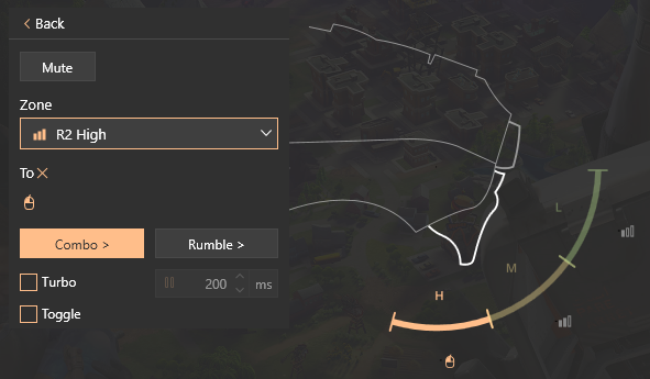

    I'm trying to set up Dualsense adaptive triggers in config where R2 is mapped to mouse click.
    I want click to be executed right after overcoming trigger resistance.
    I set Adaptive Settings to Full Press, and map left mouse button to zone R2 High:

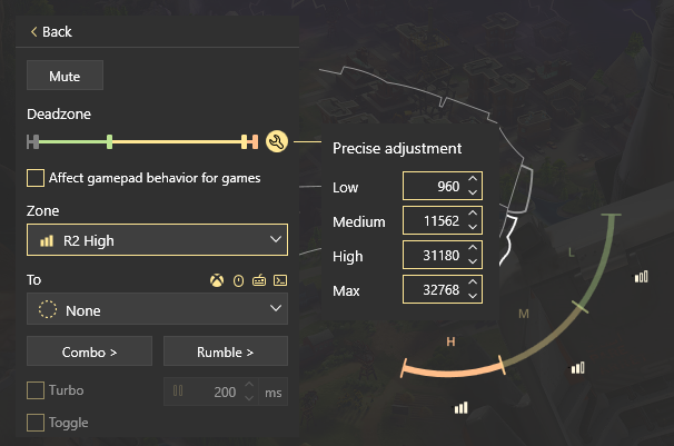

    Now LMB is pressed before i hit resistance in trigger, so I reduced size of R2 High:
    However, I don't know what is the actual value for different Adaptive trigger modes.
    Is the only way to set this up trial and error ? Or can I somehow sychronize adaptive trigger to actual button press ?
    Thank you!​
    Hmm. Thank you for pointing it out. We will add specific numbers where applicable to our DualSense Adaptive Triggers article and will notify you once it is done.
