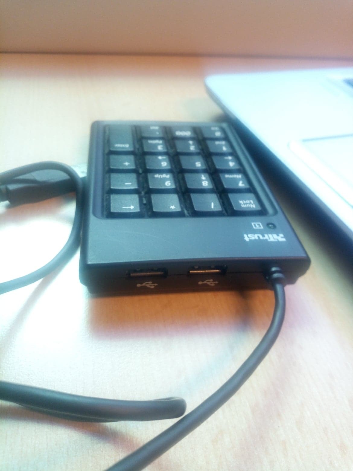

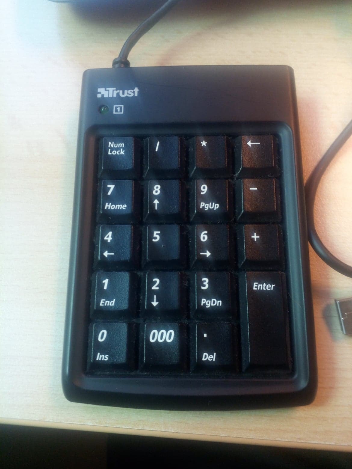

    I have a numpad that I'm using as a macropad for Premiere Pro and later, if it works, in other Adobe programs but then combined with the mouse scrollwheel. My numpad is in the attachment.
    It's wonderfull that the program can distinguesch between the laptop keyboard numpad, the external keyboard numpad and my numpad that I plan on using as Macro numpad.

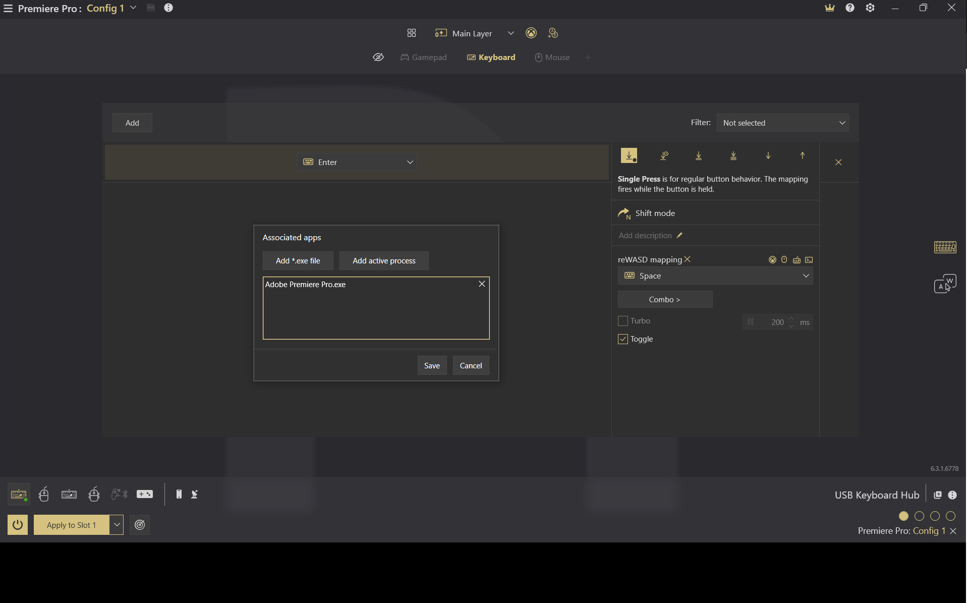

    Please send a screenshot of the full reWASD window with your configuration on it​
      I didn't configure much yet.
      I thought it was most logical to start with the spacebar function and work from there.
      I hope the screenshot helps.
        I assume that I understand, what went wrong. There is a double input of Enter and Spacebar buttons. In order to avoid the native input of the button, you should "Mute" feature, but unfortunately, reWASD forbids muting the following buttons: Right Alt, Right Ctrl, Delete, End, and Enter on the keyboard.
