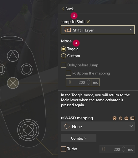

    Assign to the Start Press activator the button that you use to turn off the gyro (in my example it is a cross) transition to any other layer Shift (in my case Shift 1) in Toggle mode:

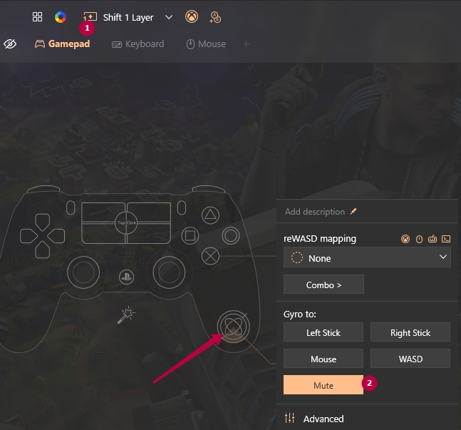

    Then go to Shift 1 and apply Mute to the Gyro. So in this layer you turn it off.

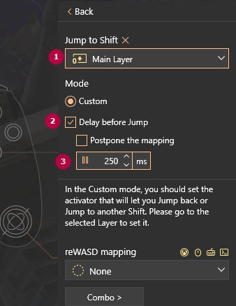

    Select the cross again and assign its Release Press activator to return to the main layer in the Custom mode, setting the Delay before jump you need.

    In the main layer, the gyroscope is constantly working, but when you press the cross once, the gyroscope turns off for 250ms and turns on again.
    I will clarify that for Toggle to work when moving to another layer, the Rapid Fire feature is required.​
      That worked great, 350 ms is a perfect amount to reset and already feels far more comfortable than manual toggle.
