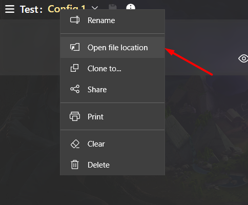

    Hello! Please send the config you are using.
    You can find your config by right-clicking on the profile name and open the file location.​

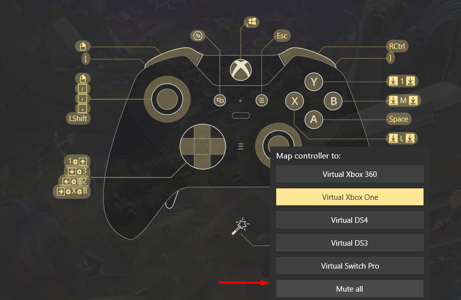

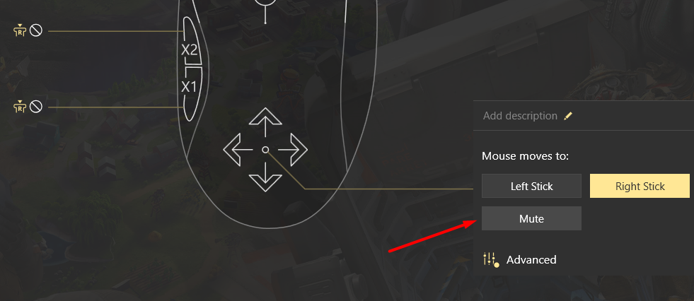

        The problem is due to the double input. You need to add Mute to avoid this.
        For the mouse, add Mute here:​
        Click image for larger version  Name:	image.png Views:	0 Size:	294.1 KB ID:	234361
        For the controller:
        Click image for larger version  Name:	image.png Views:	0 Size:	457.0 KB ID:	234362​
        Since the controller has keyboard mappings, the message may still appear when you switch to the mouse.​​
          I tried muting that on the mouse and it no longer worked in game. I didn't do the steps in the controller options last night. I'll give that a shot this afternoon.

            That fixed it. Why does muting a the mouse and gamepad allow that button to still be used? I don't think I'm understanding how mute works.
              Mute feature is muting the native input completely. Do you have the native input even after assigned Mute?

                If i muted just the mouse movement then i wasn't able to look around with my mouse in game. This may have been unintended because sometimes I have to alt tab back out to get the full mouse range to work. After muting all of the controller and the mouse movement then the game rewasd works perfectly.

                  What you've described is quite normal, as the game gets confused about what type of input you're using.
                  Your device group has both kb&m and a controller. However, you "turn" the controller into virtual kb&m, and when using physical kb&m in the game, a virtual gamepad is emulated and input switching occurs.
                  You need to decide which non-removable input type you want to emulate in the game - gamepad or kb&m.
                  Also check if you can strictly select the input method in the game settings so that it does not switch.​

                    It's set to controller and the error would pop up when it detected a mouse or keyboard input. After muting the mouse movement and the whole controller the pop up during gameplay was fixed.
                    I'm just a simpleton and it hasn't registered how this program actually works yet. Even though the controller is physically connected it still creates a virtual controller? Do I even need a controller to be plugged into my PC?

                      The virtual controller is created regardless of whether the gamepad is physically connected or not.
                      The question is, do you want to use a physical gamepad, or do you just need a virtual gamepad that you emulate on your kb&m to play?
                      If you do not need a physical gamepad, you can safely unplug it.
                      If your config contains virtual controller mappings (in your case, they are assigned as part of kb&m gamepad emulation), the virtual controller will be created in the system and the game will detect it.​
