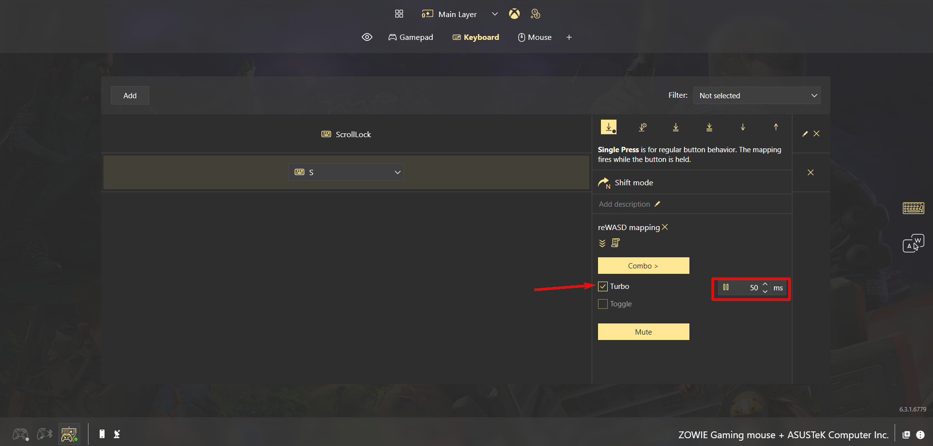

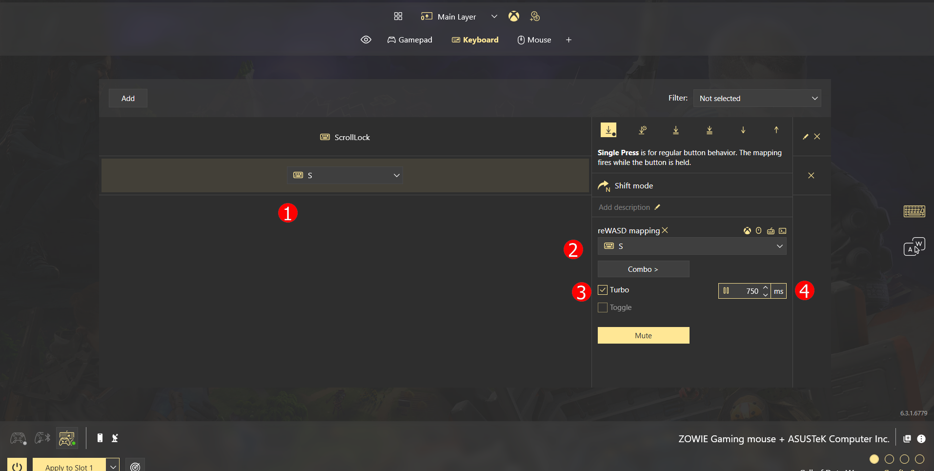

    Turbo feature permits you to adjust a repetitive pause between presses.

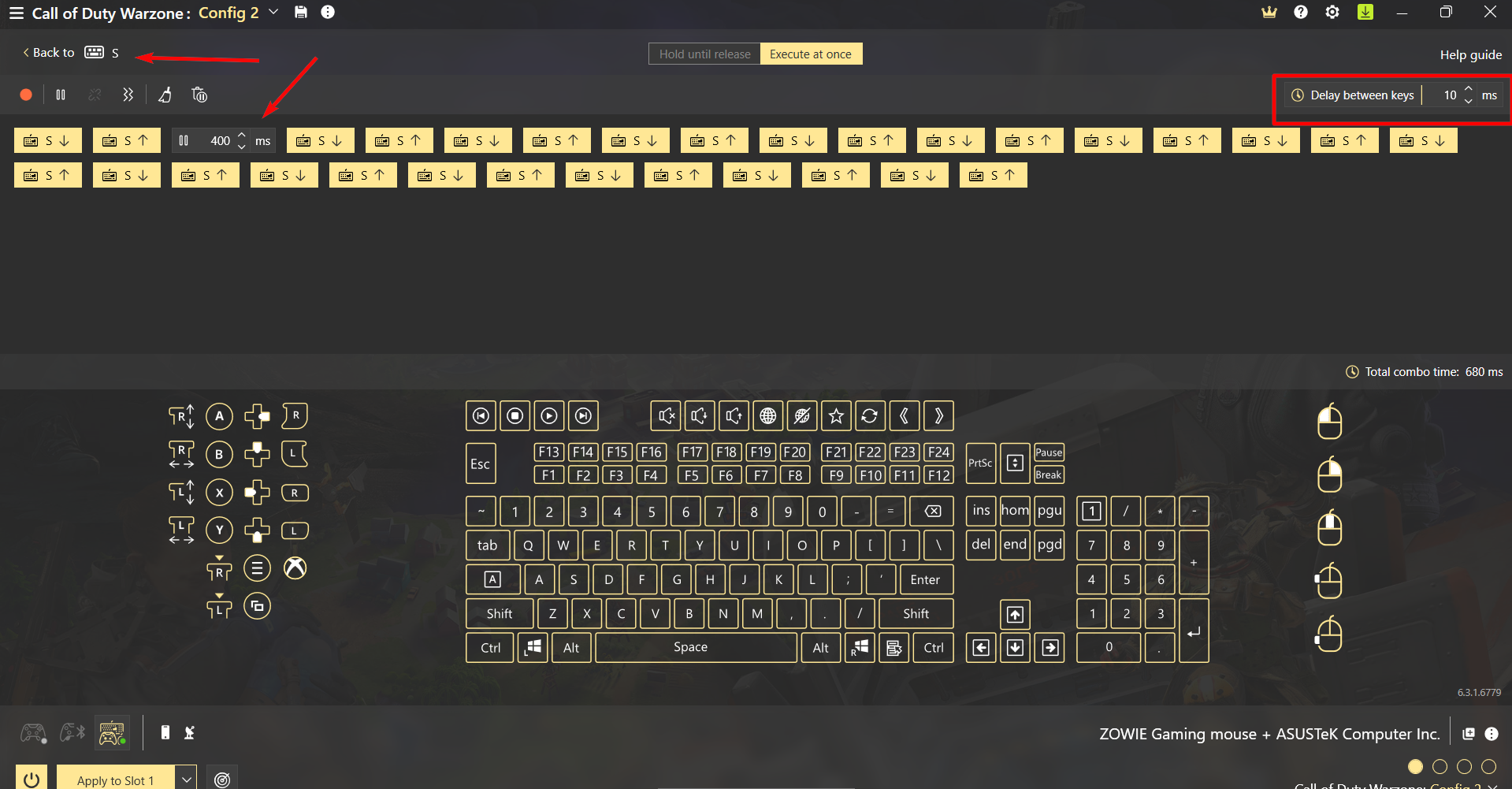

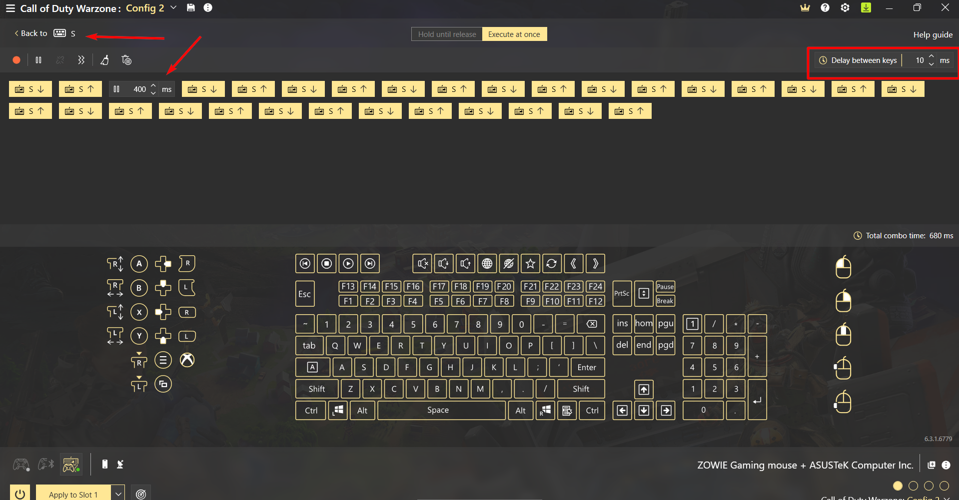

    The second workaround is creating a Combo with adjustable pauses ​between presses. You should add a needed key, then add the pause and the following repeating keys. Don't forget to check Turbo option to start Combo again after finishing.
