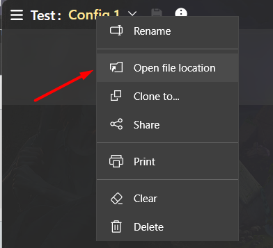

    Also send your config.​ You can find your config by right-clicking on the profile name and open the file location.
