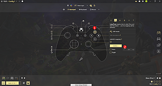

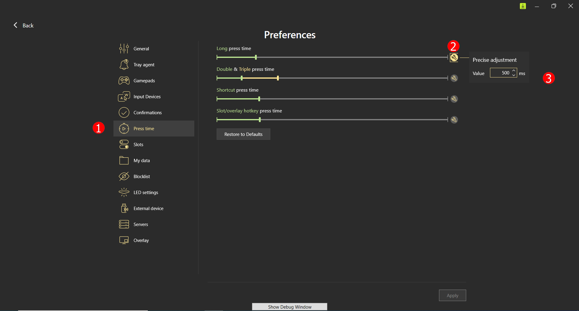

        As a workaround, I would like to suggest using Long press activator with adding a needed key to combo.
        So, you can adjust the press time for Long Press in the Preferences. For instance, it could be 500ms

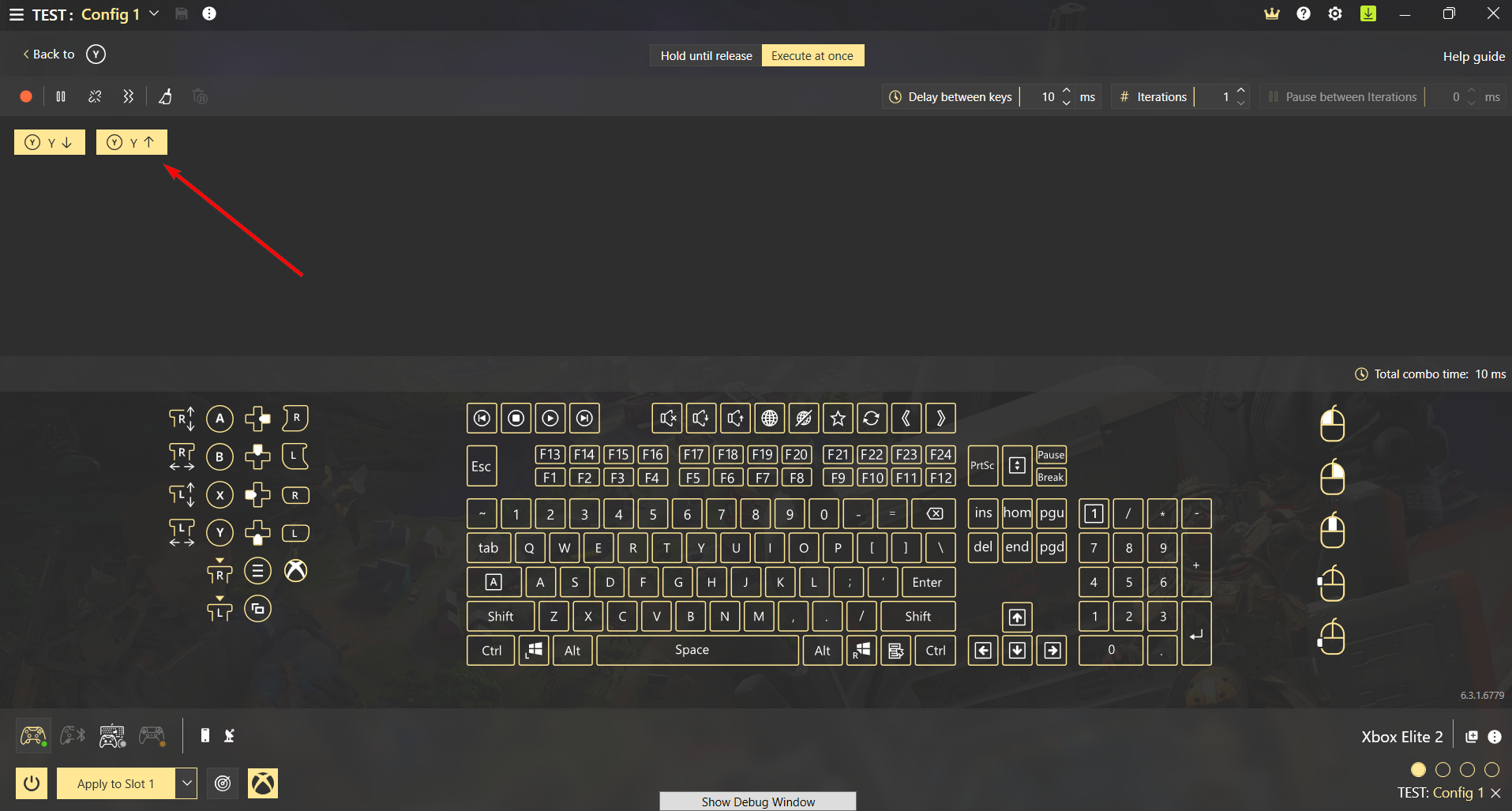

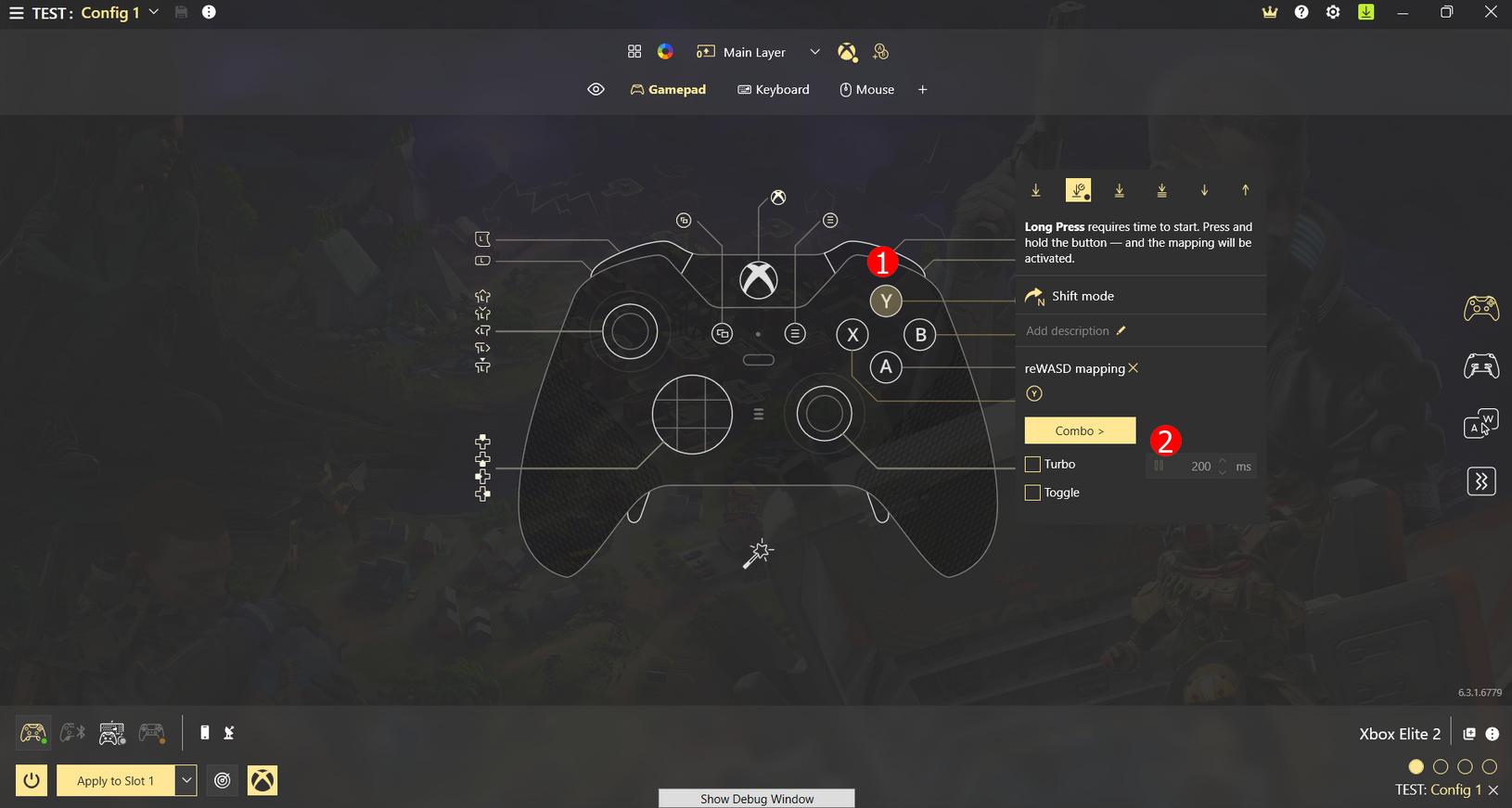

        Then, you should add the combo with a needed key. Once the Long press time is reached, the needed press will be registered. In my case is a 500ms
        I'm not sure if you looking exactly this, but probably it will be helpful as well
        Note, that if a button has a Long press activator assigned to it, reWASD will wait the Long press time before it executes whether the Long or Single press mapping. If it will be less time then Long press time, then a Single press mapping reproduces. And on the contrary, if the Long press time is reached, the Long press activator reproduces.​
