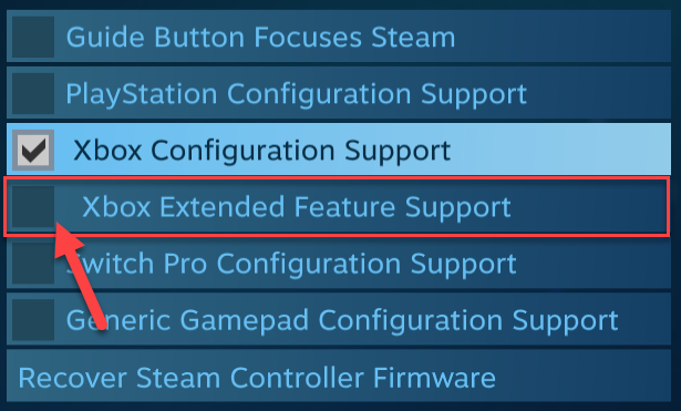

            To disable controller support from Steam, you need to go into Pig Picture mode and open Controller settings.

              Thank you. That worked. At least, Steam asked me to reboot to actually remove the driver. It's just some posts on the Steam forums (a year and something old) suggested that just unchecking the support DOES NOT remove the driver and it keeps interfering (with some Nvidia feature), and Valve even admitted the problem. But it looks like they fixed it since then.
