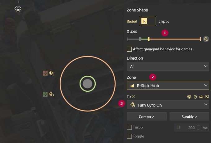

    Something very similar can be done via stick zones in Advanced stick settings.
    You need to divide the stick into two zones - Low (make it very small, because when you reach this zone the gyro will turn off), and High (fill all the remaining space with the High zone).
    Then assign two commands - Turn Gyro off for Low Zone and Turn Gyro On for High Zone.
    This way the gyro will be on while the stick is deflected and will turn off as you approach the dead zone.​
