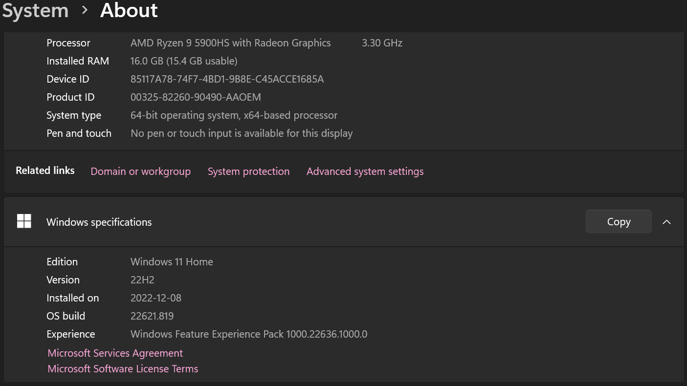

    Could you please provide your OS version?
      Hey there, thanks for the swift reply! Below is an image of my System Properties.

        We had some reports already that bluetooth connection with Nintendo Switch was not working anymore after some latest updates in Windows 11. It is still under investigation.
