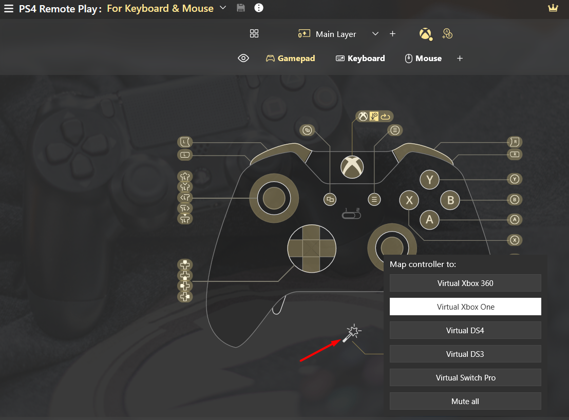

    I'm totally noob- I have no idea how to set this two devices as Xbox one controller. I remapped PS3 controller to wasd (that works properly) but I want to set it as xbox controller as well as mouse to right thubmstick.
    I will be apreciate to any sugestion.
    Hello! First, group these devices. After that, take the PS4 Remote play config as the basis and reassign your controller with the magic wand as a Virtual Xbox.
    After applying the config, your mouse will lock, because we mute native input and assign right stick to it. To get the mouse back, press Left Windows button.​
