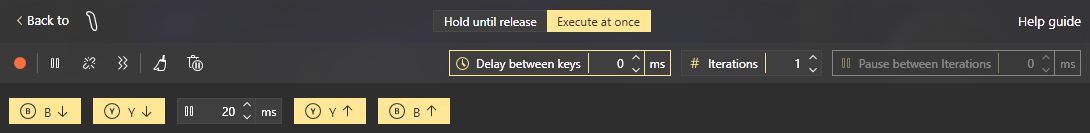

          Looks like there is a misunderstanding. Adding a button to the Combo does not trigger the mapping set for that button, it triggers a button on a virtual controller instead.
          So what you have to do is to change your [Combo] to something like this and enable the [Turbo] flag for the mapping:
          Note: Rapid Fire feature will be required for the Turbo function to work.
