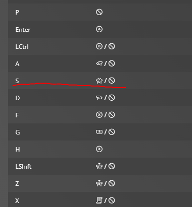

      This config does use S key

        I suppose I should explain the "A remapped to B" construction first: it means that when "A" is pressed, the "B" will be triggered, not otherwise.
        So while the [S] key is remapped to [Left Stick Down] in your config, the [Left Stick Down] is not remapped to [S], meaning that moving the [Left Stick Down] on a controller would not produce the [S] key, and thus would do nothing if the game is set to listen to keyboard and mouse only. Due to the [Mute] flag on the [S] key mapping on your screenshot, pressing the [S] key would produce the [Left Stick Down] action only, which will also do nothing if your game is set to listen to keyboard and mouse only.

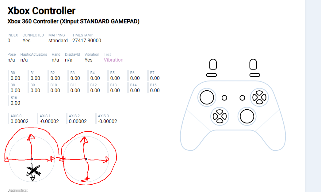

          Hum sorry, I did not explain my self clearly.
          I use my keyboard/mouse to emulate an Xbox controler. So when I press S, I want the virtual controler to use the left stick and aim down. I don't have a physical controller connected to my computer.

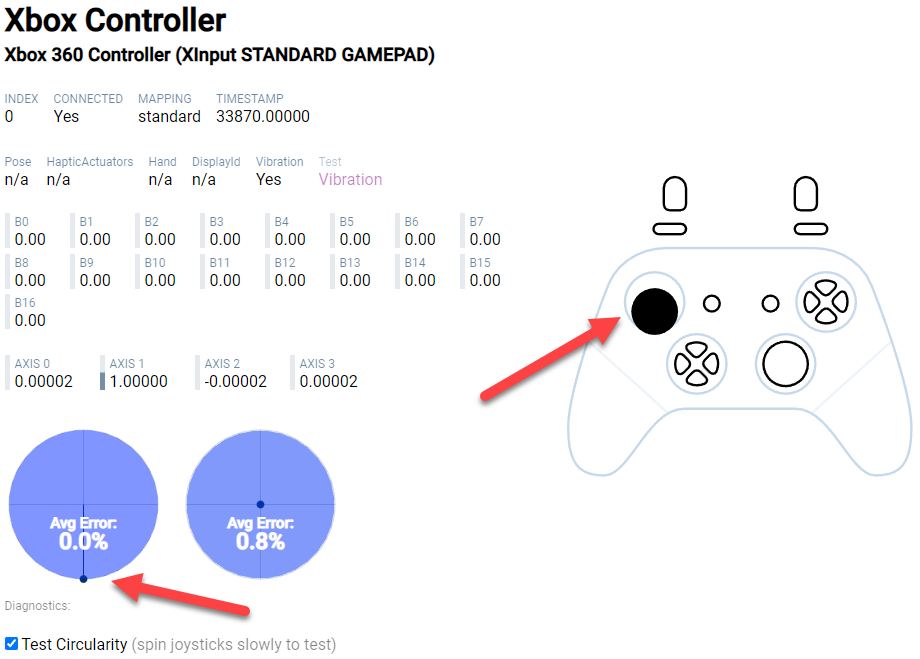

          The game does get the controller and is set to the controller. I even tried on a gamepad tester online:
          All remapping W/A/S/D are configured as muted and to the left stick and different directions​
