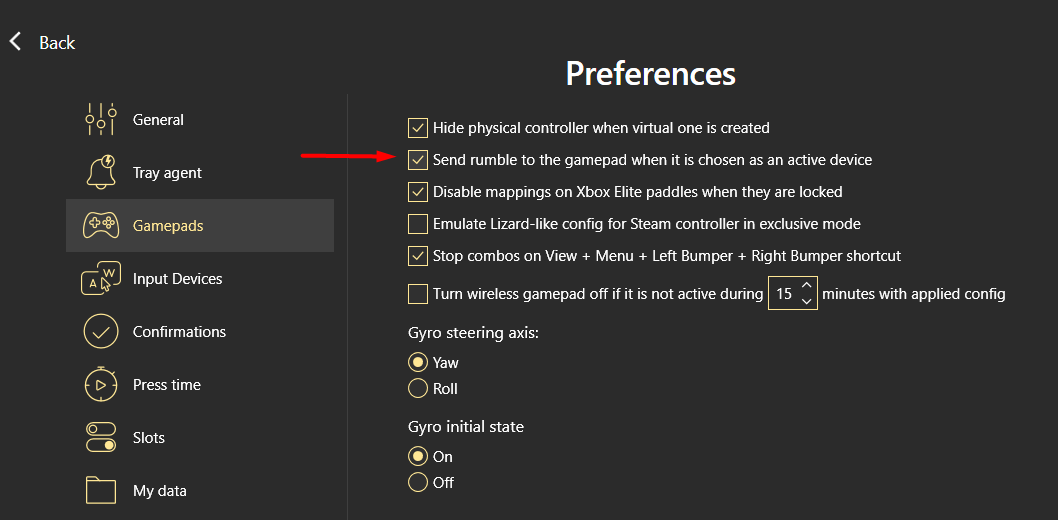

            Hello! Please try to disable this checkbox in Preferences -> Gamepads and reconnect your controllers.
            Click image for larger version  Name:	image.png Views:	0 Size:	48.7 KB ID:	235060​
              Hi, it was disabled, seems i turned it off when i installed rewasd.
              So no change is possible there sadly.
                As an option, try to go to Preferences and hit on [Clear Data]. Once the GUI will restart, reconnect joycons and check if the issue still occurs.
                  Tried it but no change.
