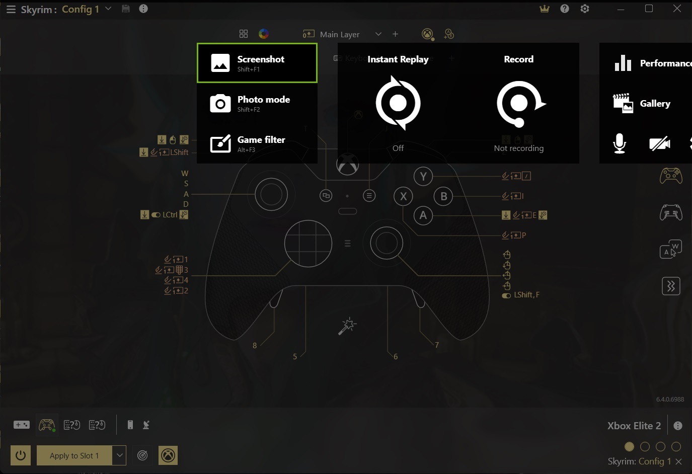

    Hi everyone. I have included as many images as I thought would be apt as well as my config file. I'm using reWASD with Skyrim. Everything seems to be set correctly and when the game begins, I get a notice that reWASD is activated for the game, but when I'm in-game, it's just the default settings. None of my reWASD settings work.
    Your config contains keyboard and mouse mappings, which shouldn't be a problem.
    Try turning off virtual controller emulation.
    To do this, click on “Magic Wand” and then turn off the virtual controller.

        In your screenshots, I see that the configuration is only applied to the Elite 2 controller. Therefore, once again, make sure that the config is applied only to the gamepad and that your physical keyboard is not in the group with the gamepad.

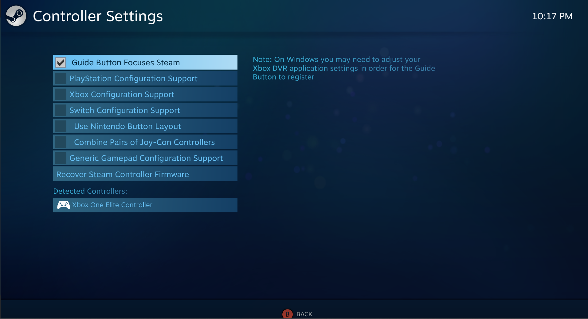

                2. Open Steam Settings → Controller → General Controller settings. A window will open in the Steam Big Picture. I need a screenshot of it.​
                  Here is the screenshot.
                    You should uncheck all boxes, including the first one.
                      I've unchecked it as well. I'm still having the same issue. Is there anything else it could possibly be? Maybe some setting I have incorrect in reWASD? I made a blank profile as was suggested and I have the correct slot on my controller as I do in reWASD.
