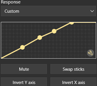

      here you go, the left stick settings are default with the exception of me adding a deadzone to the curve

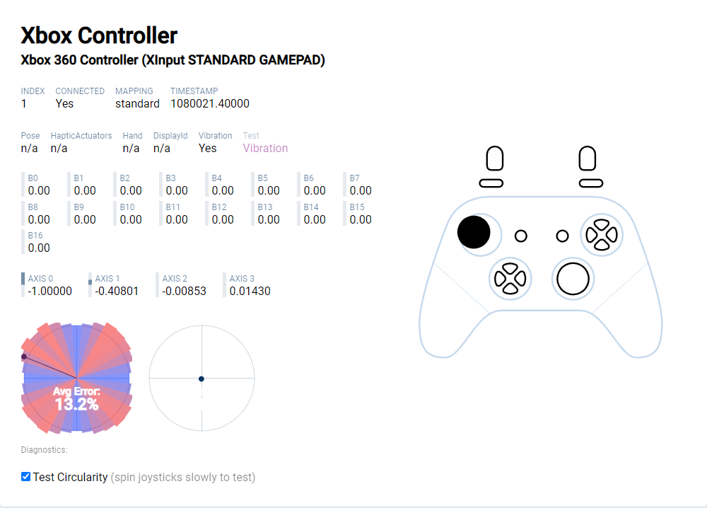

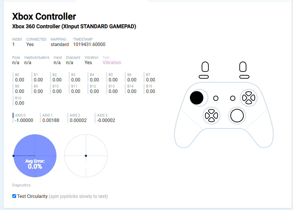

          Alright, after checking it with the gamepad tester, I can see that with reWASD disbaled, the default shape on my controller sticks is more of a squircle which is why reaching the 100% deflection is easy.
          When I enable reWASD it turns it into a circle.
          Is there a way to either add some kind of an outside deadzone or to make the shape more square than it is? The way it is now is literally making the reWASD unusable in my case, where I only require one axis of the stick.
          I also happened to have another Elite Series 2 controller lying around and tested it with identical results, which means that this is a common thing with this particular controller.
          Below are the results from testing my main controller, holding the stick at the angle limit where I still get 100% deflection, with and without reWASD

                  You can set the outer deadzone by shifting the last point of the response curve to the left along the X axis, but at the same time it would reach the maximum value along the Y axis.
                  Then the stick will reach 100% before you deflect it to the edge.​

                    Sadly I guess this wouldnt solve my issue either, because even then I would need to have the stick at a perfect 90 degree angle to reach the 100%. And when I say perfect I really mean that it would need to be so perfect that I could argue nobody would consistently hit it during actual play.
