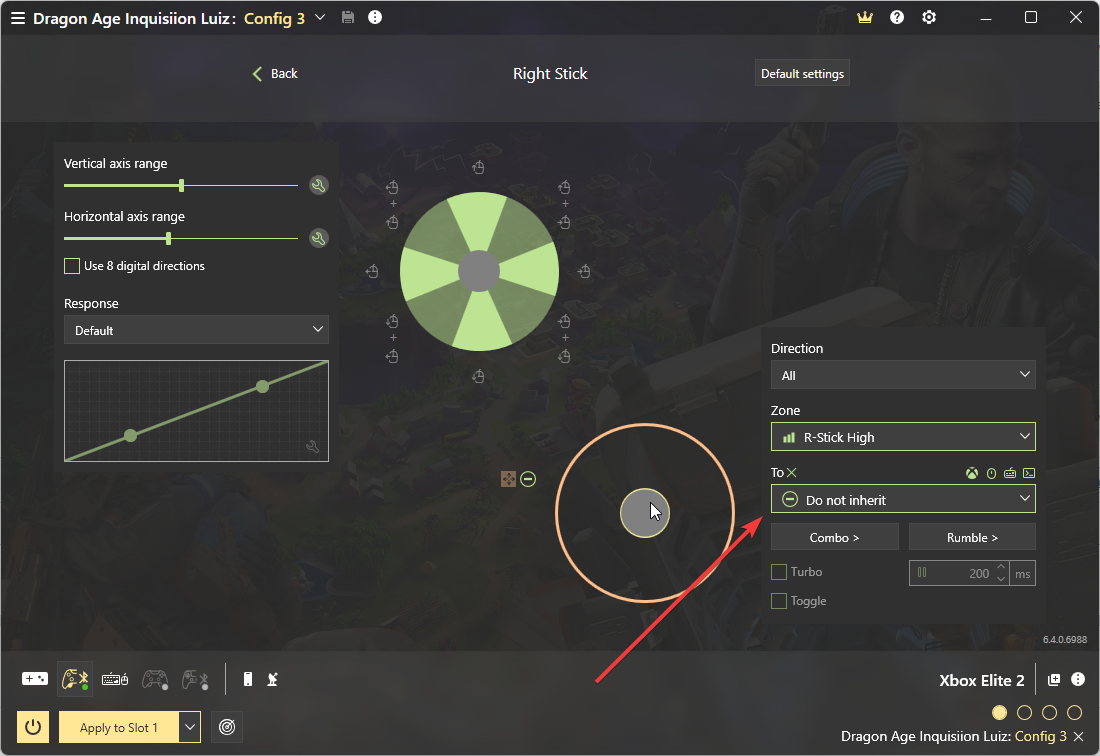

        All you need to do to achieve your goal is to add [Do not inherit command] on Layer 2 in the advanced settings of the right stick.
        Click image for larger version  Name:	image.png Views:	0 Size:	409.1 KB ID:	235300
        A long story short, If you have added any mapping to sticks or trigger zones, and you don’t want them to reproduce while the Shift overlay is active, you’ll need to open the Stick settings inside the shift and pick Do not inherit for the zones as well​
