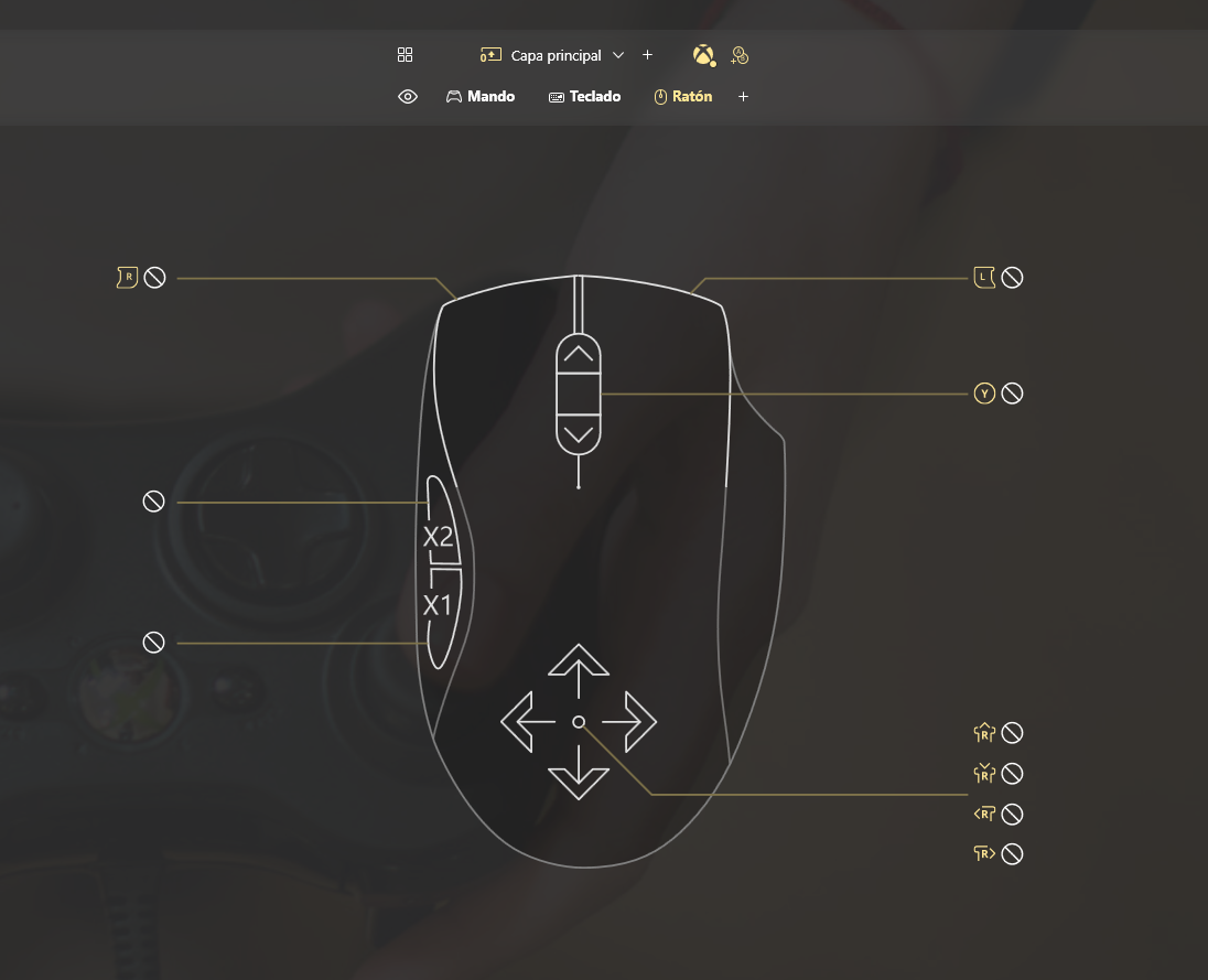

problem with the battlefield 2042 mouse it is not blocking to be able to use the aiming assistance, despite blocking when moving the player it takes the native mouse deactivating as if it were a control, sorry for the bad English I am using google translator, no I know if I can write in Spanish​

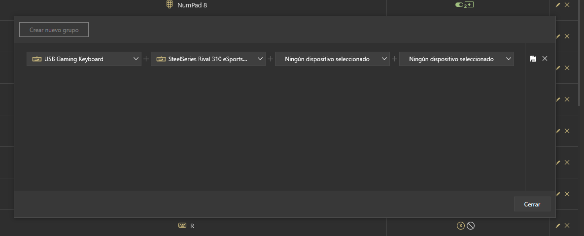

The reason is that your mouse is initialized as a keyboard.
1. Remove a device group.
2. On the bottom left, select your mouse (SteelSeries Rival 310) as the active device.
3. In the context menu, click on "Re-initialize" and initialize it as a mouse.
4. Group your devices again and apply the config.
