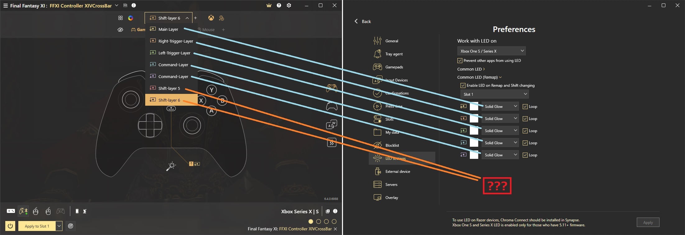

Today I added a 5th Shift Layer and found that pressing the button, the processes in the tray crashed. And whether I had 5 or 6 layers, anything outside of the first 4 would crash the tray processes.
The Event Viewer gave me:
Since it mentioned LEDs I looked around and in the Settings. Under LED Settings found the option "Enable LED on Remap and Shift changing" and disabled it. This fixed the problem and I no longer experience the crash. Its weird that I got an issue about LEDs because my controller is not an Elite but a simple Xbox Series X | S.
I'm gonna assume as the preferences menu only takes the LED options for the default 5 layers (default + 4 switch layers) into account, and whenever you access a 6th and beyond, it attempts to check which LED "effect" to apply and throws an out of range exception?
Either way! The crash happened on both the LB button and Share button, I've tried to attach what I did to fix the problem at least temporarily and attached the generated logs. I figured it was worth reporting it in case anyone was having the same issue.
